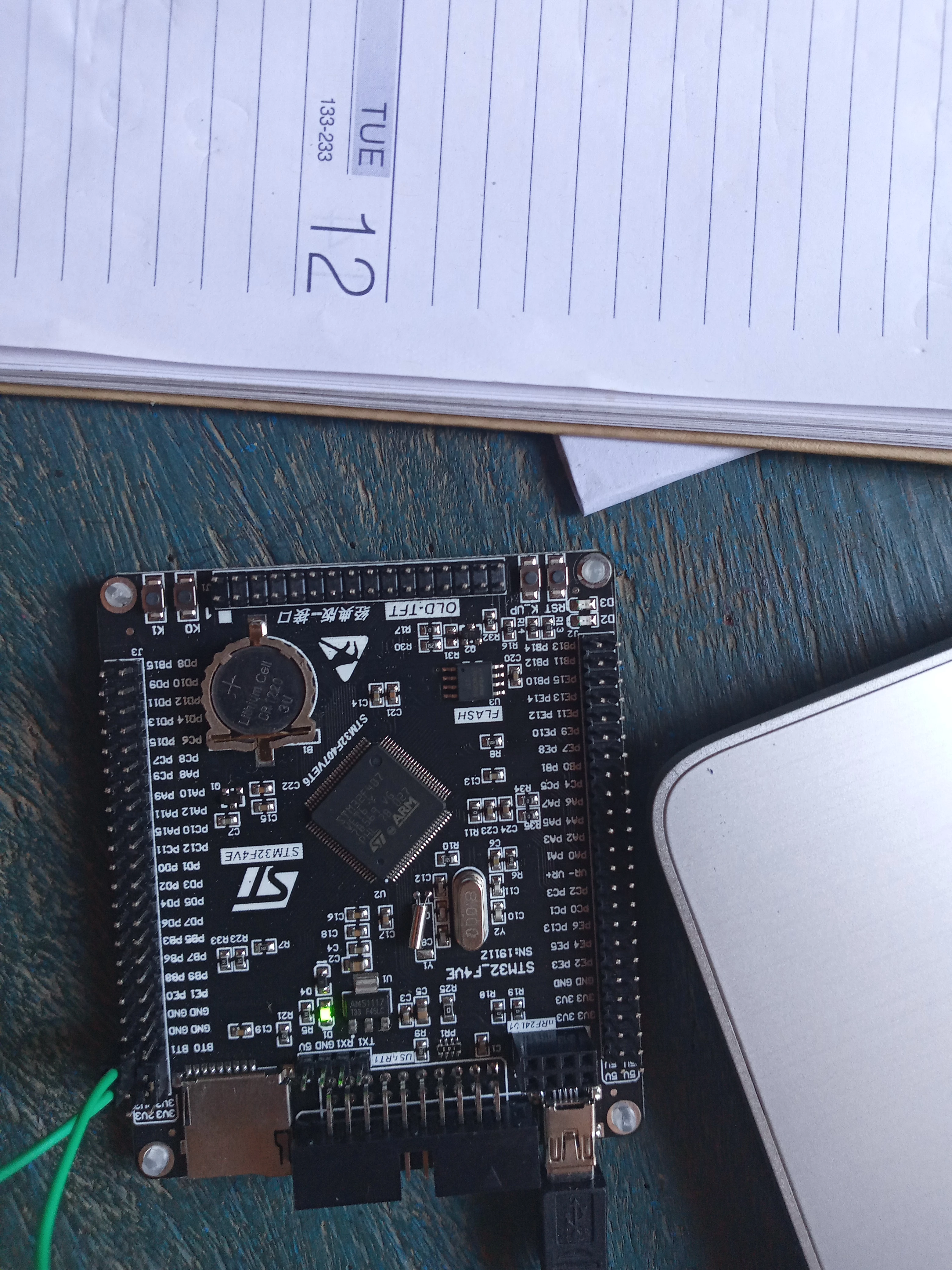

I am using stm32f407vet6 micro-controller. when I connect it into windows laptop and try debugging with cube ide it is showing NO ST-LINK DETECTED, CONNECT AND RESTART DEBBUGGING. I don't know how to fix it. In device manager I found STM bootloader o

It sounds like you are connected to the chip directly and not through a debugger like ST-Link, which is required if you want to debug.
What board are you using? Custom board?

Thank you for replying. Yes I connected it directly. Do I have to buy a ST-link, I thought it is in-built. I am sending a picture of my board.0693W00000FBZTKQA5.jpg

On the majority of genuine ST boards, there is an on-board ST-Link used for debugging.
On that board, and most other clone/counterfeit boards out there, there is no ST-Link and you must get one.
https://stm32-base.org/boards/STM32F407VET6-STM32-F4VE-V2.0.html
