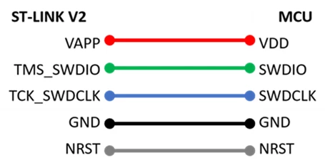

I am having customized PCB board for particular application. i connected pcb board through ST-LINK/V2 through which i shaving 5 pins . 5V,GND, JTCK,JTNS,NRST. My question is should i connect external power supply to flash the program ?
should i connect external power supply to flash the program.
when i connect ST-LINK/V2 to PCB board i get the error called "no cortex-m device found".
"no target is connected".
Please anyone help me to flash the program to my customised pcb board.

in the above pin it is JTMS

If the CPU is not powered by the st-link, then you need to power it by external power supply.​

from the ST-LINK
_legacyfs_online_stmicro_images_0693W00000bkwJLQAY.pngThis is the connection

Check on board: is CPU vdd 3.3 V ?
And connect: software reset mode .​
