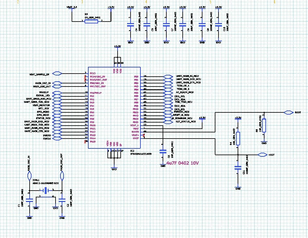

So, I have a custom board that has on it an STM32F411CCU6TR.
Initially i populated the entire PCB including several peripheral components. A sensor, an RTC and cryptographic security IC.

I am sitting here now thinking that i have zero control over this regulators output and i cannot see what i can do in terms of circuitry to make it not put out this voltage. I have tested the peripherals on the PCB by connecting into the I2C bus and i can communicate with all of them, so clearly my VDD voltages are all good enough to support comms via I2C and none of the devices are causing an issue. It seems isolated to the STM32 but internally.
So my experience of STM32 devices so far is that they are sensitive little buggers and i have a 100% (2 devices) failure rate. I have trawled over my schematics and i am thinking that even redesigning it wouldn't help me because based on my understanding of how it works, i wouldn't want to change a thing.

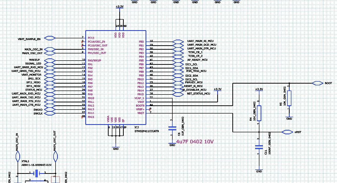

I have attached the STM32 schematic, The quality isnt great as the software i am using doesnt yet export to PDF. S i have added another one to clear it up so you can see the chips pin out better.
Also in the schematic it shows a 4.7uF 0402 cap for Vcap. Throughout the above debugging it has been swapped for a 10uF 0603 X5R.
All of the pinouts go to headers so on my bare populated PCB there all those pins are floating.
I am thinking that due to not properly understanding the STM32 that i have possibly used a pin for a task and its an important pin. But despite looking over and over i cant see where it would be.
Can anyone offer anything at all that might help to understand this issue???

VREF+ (VDDA) should be powered

Clive, You mate, are a legend. I left VREF+ disconnected since i wasnt using the ADC. Also from my experience of using PIC i have never needed to use it.
Connected VREF+ and it starts up and connects.

AN4488 section 2.2 point 3 says "VDDA pin must be connected" and figure 2 shows "Analog: RCs, PLL, ...". By RCs they mean RC oscillators - HSI and LSI. As after reset MCU starts from HSI, VDDA is absolutely necessary. Also, because of starting from HSI, crystal/oscillator is not required for a bare minimum and not required at all, if HSI tolerance is enough for your application. SPI, I2C and USART run as a charm from HSI based clock... =)
