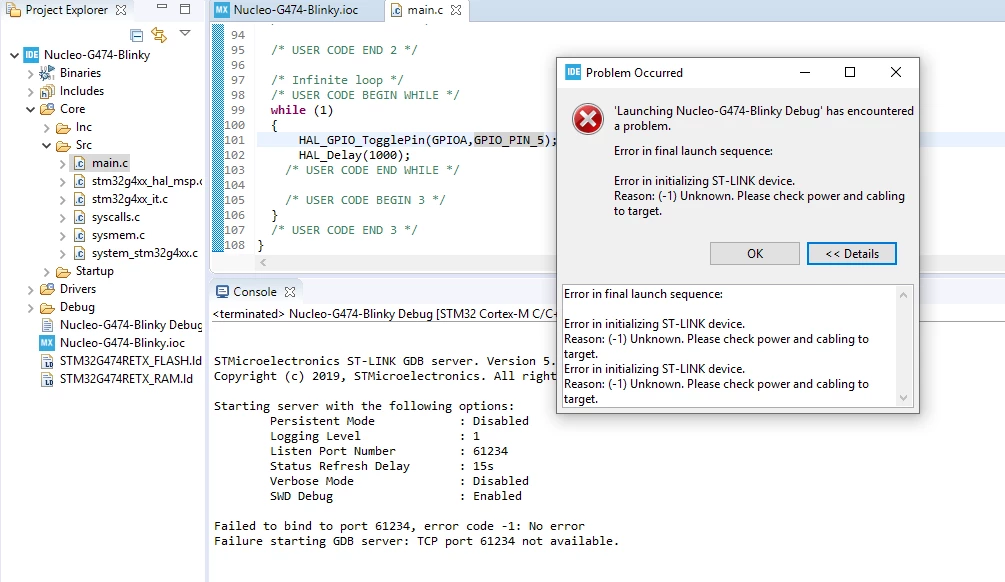

I am beginner. Board: Nucleo STM32G474RE , Has STLink V3E on the board. IDE: STMCubeIDE ; Host OS: Windows 10 Pressing B1 has no effect. LD2 does not blink. getting ST Link Initialization Error - Image in details below.

trying to blink the LD2 on PA5. Getting following error. Please help in resolving.0690X00000BvWEhQAN.png

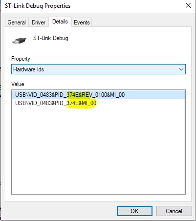

STLINK is installed and showing in Device manager

Looks like the ST-LINK drivers are not installed.
My Details tab reads "STMicroelectronics STLink dongle", but yours shows only generic USB ID.
The drivers can be downloaded seperately (STSW-LINK009).
