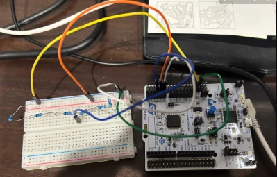

I am unable to obtain ADC values and would like some advice.
Here is the source code project.
https://github.com/katsumat/STM32CubeIDE/tree/main/workspace_1.16.1/ADCCalibration
PA0 is connected to GND, PA1 to Vdd, and PA3 to the output of a variable resistor.
The ends of the variable resistor are connected to Vdd and GND, ensuring an output range of 0 to 3.3V.

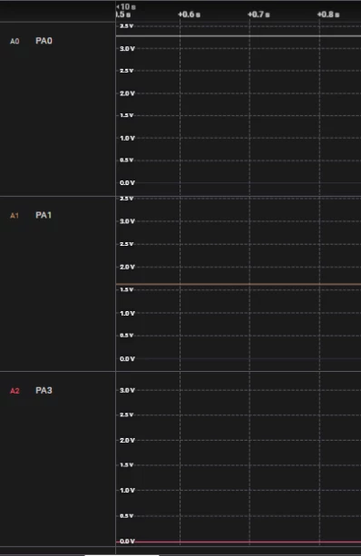

The input voltages for PA0, PA1, and PA3 are as follows:
Here are the results after setting a breakpoint and checking:
The variable did not hold any value.
