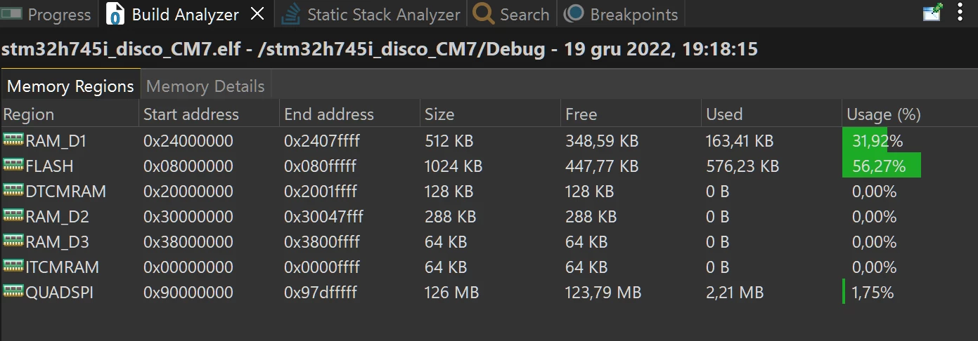

The project is made with STM32CubeIDE. Uploading from it is simple and works.
Then I used CubeProgrammer to upload .hex file. Also works.
But both require installation and configuration on the target PC.
However, the device is seen as an USB disk.
0693W00000WLLiJQAX.png0693W00000WLLiOQAX.pngThe problem is - the HEX file is too big to fit in there. Is there a workaround for it?
I tried to generate a BIN file, but it's 2GB - why? My whole project doesn't use that much data.
Here:
0693W00000WLLinQAH.pngI need to send the update to someone that has the device, but no ST software installed. What are the options?
My plan B is to send them CubeProgrammer and HEX file.
BTW, HEX file is not the optimal in size. It stores the binary data as text, that use at least 3 times as many bytes as raw data. Why is BIN 2GB? It should be smaller than HEX. Is there any other format that could be used to flash the chip by just copying the file to that special "UBS disk"?

>>Why is BIN 2GB?
Because binary files can't be sparse (ie containing large voids), and describe memory at 0x08000000 up through 0x90000000, which is around half the 32-bit 4GB address space.
You'd need to break it into pieces, some of the better tools will do that.
Still the QSPI space is bigger than 4MB, and not supported by the ROM boot loader. It supporting the eMMC would surprise me.
You want to push something in, you're going to have to make a target side USB-DFU loader, that's aware of the QSPI memory, they pins and the type/size of device.
You could perhaps make a USB-MSC loader that's got awareness about .HEX or .ELF files.
Or you could use the ST-LINK/VCP and make a loader on the UART that can do X-MODEM from a terminal application.

I still don't understand why binary files can't be sparse (like sparse arrays in JS). It's just how every executable is: address, length, data bytes, in binary. It's probably how the HEX file works, but well, so either we treat bytes as text, or to place a byte at 0x0000 and another one byte at 0xFFFF we need 64kb? OMG, that BIN format is so useless.

Primary question is your QSPI data new require update?
Second create hex, then split it and convert hex2bin only flash part... resp leave it as hex flash part will be less as 6 MB

If they have Windows, they can use a smaller simpler ST-LINK utility.
As for QSPI flash - Segger's J-Flash has the "universal QSPI" support that automatically detects many QSPI flash chips. All it needs to know is the exact MCU model and pins of QSPI (TL;DR) - this effectively replaces the "external loaders".
Unfortunately you cannot use it with the onboard ST-LINK, it requires a J-LINK.
> Keil, by default sees multi-section objects, and breaks them into different .BIN files
IAR has a similar utility that splits ELF to several bins.
They also produce additional executable format, "simplified ELF" IIRC - like ELF stripped down, without all the spam. Size is close to the sum of binaries.

Say that your code is made of 2 bytes of value 0x11 and 0x22 in order, the first one a address 0x0 0000 and the second at 0x1 0000
The bin file will be 65537 bytes with first byte 0x11, last one 0x22 and all other will be probably 0x000
It is a binary memory dump contiguous file, like a whole screen capture.
HEX and S19 files are text file, which each line describe a memory slice with start+size address. In this case it will have 2 text lines for the 3 data bytes amd the rest will remain unchanged. It is like taking 2 small screen rectangles captures separately.

I figured it out from the first answer. So the Cube's bin format is the worst format ever. It may accidentally work when all data is just one contiguous block We are missing one format: bin is too dumb. Hex has too much redundancy. Elf - from what I read - also has some redundancy. And the problem to solve here is much easier than all the problems I had to solve to make my first devices built from those bricks work. I remember writing my own assembler on Atari 800XL, with only two directives "* = [address]" and "db [byte, byte, ...]". So in my asm file your example (trimmed to 16-bit addressing) would go like this: "*=0x0000 db 0x11 *=0xffff db 0x12" - 33 bytes compiled to even smaller executable that loads those bytes into exact locations. I was 10 back then and read exactly 2 books about programming. One was basic manual, the second one was a kind of datasheet for Atari. BTW, Atari DOS had an executable format that worked exactly like this - "0xff ([addr] [length] [data]...)...".
