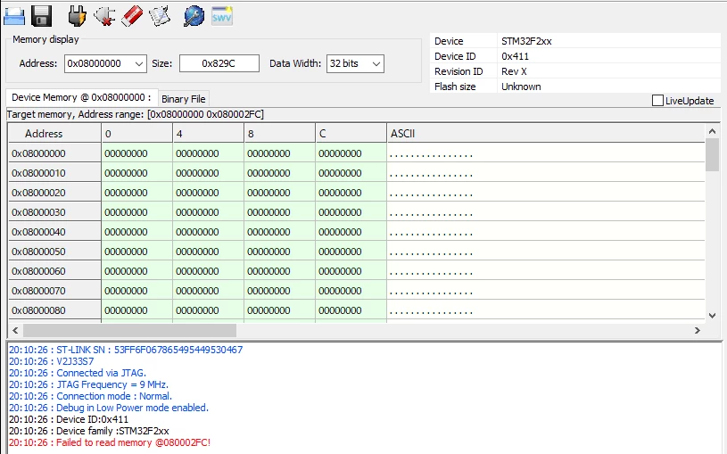

How to solve "Failed to read memory" error in ST-LINK Utility
Hello.
I want to write a program on M3 HiBot TITech Tiny Controller.
This board uses STM32F205 VCT7.
I connected ST-Link / v2 and the board by JTAG to write the program.
1 (JTAG on the board) → 1 (TVCC: ST-Link / v2)
3 → 5 (TDI)
4 → 7 (TMS)
5 → 9 (TCK)
6 → 13 (TDO)
7 → 15 (STM32 RESET)
8 → 18 (GND)
I performed "Target"-> "Connect" of ST-LINK Utility, but an error like an image occurred.
I tried looking for similar errors but it did not solve them.
Please give me a solution.

Hi.
Try to decrease the JTAG frequency from Menu->Target->Settings or /and try to change the Reset Mode from HW to SW.
Check also at Menu-> Target->Option Bytes if Read Out Protection is enabled.
As third option, reconnect device with SWD port to STLink (SWCLK,SWDIO,GND).
if stlink insists to stop reading at 0x080002fc flash address, indicates a HW error.

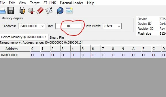

OK. Try not to read so much bytes but change it to eg 16 as below.

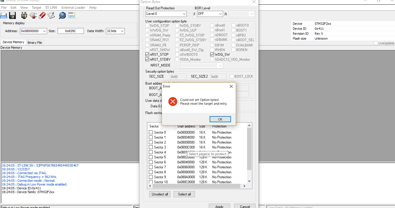

However, when I try to change RDP, I get such an error.
I found a person in the same situation as me.
https://stackoverflow.com/questions/44626010/read-out-protection-enabled-without-any-action-and-cant-be-disabled
The same thing happens with this video in this article.
https://giphy.com/gifs/3ohzdRZHrSVNO1qgBa
Seeing the answers, I doubted that the pins were not well connected.
So I checked using a tester, but there was no problem.
During the check, there was a rare occasion when RDP could be changed. (When I turned off the board, I got the same error as the first one.)
Unfortunately, there is no repeatability.
