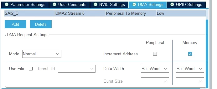

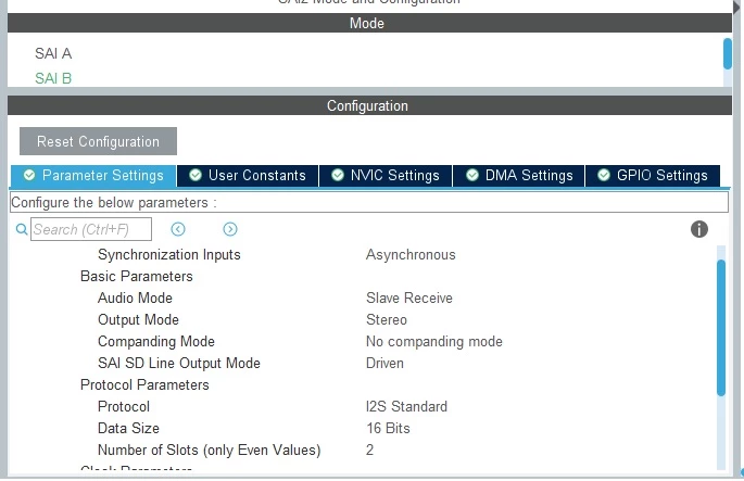

I am trying to use the audio on stm32f746g-disco.
I can hardly find a tutorial for this.
Many solutions got their way to solve it and left not much details.
lots of the solutions guide to the examples in CubeMX , but they seems a little bit old and I can't figure out what is the examples are doing
For now I tried to init SAI2B to receive data
but it not like getting any valid data or triggering half and complete callback
i've attached my main.c ,and the setting of SAI B and its dma
take a look if you have time
thank you

Not sure what the problem is.
Start using the audio player example under this path:
Projects/STM32746G-Discovery/Applications/Audio/Audio_playback_and_record
If it does’t work, indeed there is an issue, if not inspire from the example.

Hi SofLit,
I can see it. I just realize it is set to use the microphones for the audio loop back example.
but when I plug in my earphone , it just have constant electric sound.
What do you think the problem is ?
