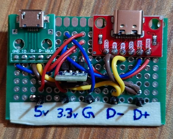

Jan 23, 2026 1:42 PM UTC
Hi again @Mike_ST @FBL ,
Thanks for the clarifications so far — that helped me understand the board limitations much better.
I’ve now prepared a small USB interface board that supports both USB-C and Micro-USB, and it cleanly exposes the following signals:
  • 5V (VBUS)
  • 3.3V
  • GND
  • D−
  • D+
(see attached image)
My goal now is to connect this interface correctly to the NUCLEO-G491RE in order to use the ROM DFU bootloader of the STM32G491.
I would appreciate guidance on the following next steps:
1. Signal connection to the NUCLEO-G491RE
From what I understand so far, CN2 should not be used, and the USB pins of the STM32G491 are available on CN10.
Could you please confirm:
  • Which exact CN10 pins I should I connect to:
    • D+ → PA12
    • D− → PA11
    • GND → ?
    • VBUS (5V) or VBUS sense (if required) → ?
A small pin-to-pin confirmation would be very helpful.

Mike_ST
Jan 23, 2026 2:12 PM UTC
Hi again,
I have never tried such a setup,
but from what I read, I don't see immediatly anything wrong.
  • GND → any ground pin.
  • VBUS sense (if required) →  VBUS sense not needed
  • VBUS (5V) → depends of how you power the board → maybe try not to connect it if the board is powered from the ST-Link connector.
Just for the "3. Entering DFU mode", the STM32G4 has some option bytes to select the boot mode. Either the boot selection (main flash or boot rom) is taken from the Boot0 pin, either it taken from the option bytes settings.
As far as I know on the MB1367, the option byte approach is chosen when the boards are manufactured, so setting JP7 might not help.
