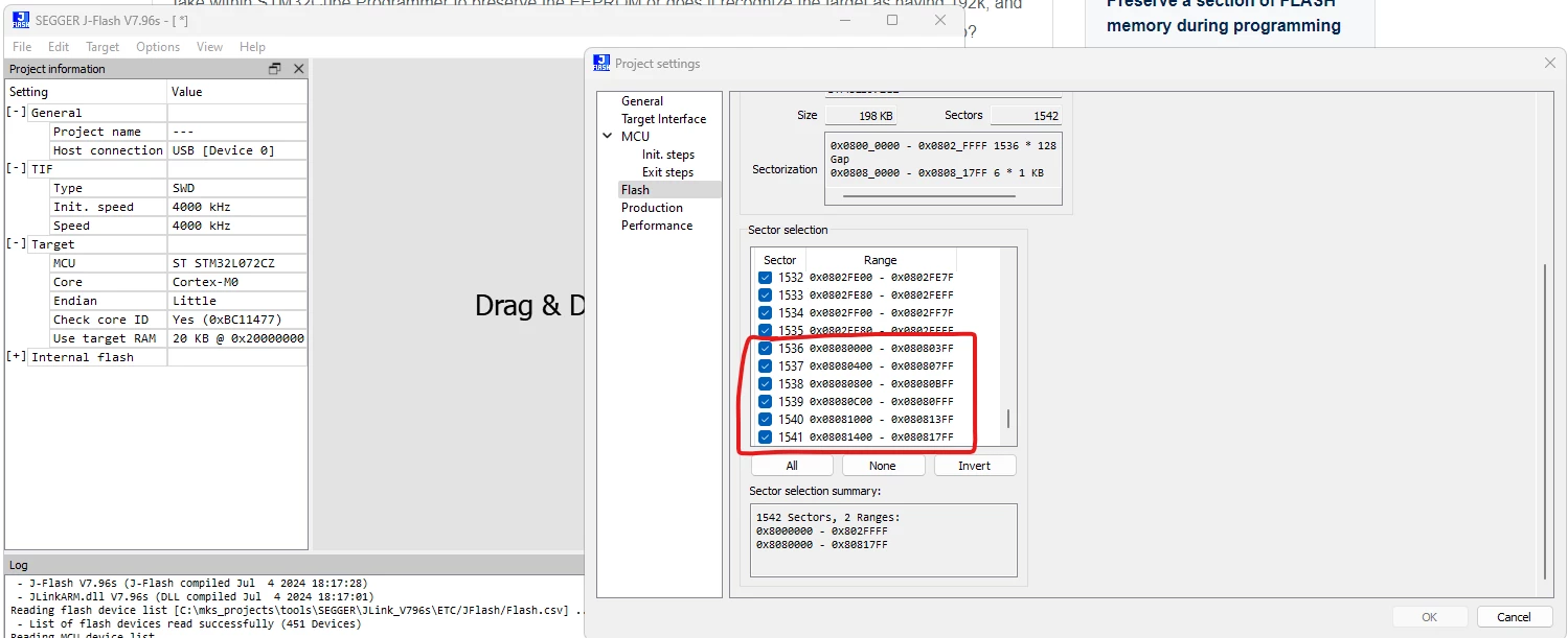

We have a part on our custom board which includes a STM32L072CZ.  The part was shipped with obsolete firmware, and we are trying to upgrade the firmware with the new image provided by the manufacturer.  We first tried to upgrade the firmware using Segger's J-Flash utility and a J-Link Plus.  We were able to reprogram the firmware, but in the process it apparently wiped out the 6k of EEPROM.  J-FLash's target selection shows the STM32L072CZ as having 198k of flash, but it should be 192k of flash.  I'm guessing the additional 6k is the EEPROM.

I can suggest something with J-Link and J-Flash tool.
When I created a new project with the suggested micro using JFlash, I got the two memory ranges.
It looks like that
0x8000000 - 0x802FFFF :right_arrow: is for application code
0x8080000 - 0x80817FF :right_arrow: is for saving data similar to EEPROM and is of 6KB
In J-Flash Project you can go to "Project Setting" :right_arrow: "Flash", you can uncheck the memory ranges you don't want to program.
As you can see the "check box", just uncheck and use the project, then J-Link will not erase the memory ranges that are not selected.
Just make sure to not use "Erase Chip", it will still erase the complete chip, instead of the use "Erase Sector"
Hope this helps

tkobetAuthor
Aug 26, 2024 5:38 PM UTC
I was wondering if something like that would be possible, but was not familiar enough with J-Flash to know.  I had looked up the address space of the EEPROM area, so was moving in the right direction, but your response definitely sped things up.  I should have known better than to do an erase chip.  I excluded the 6k EEPROM area from the eras as you suggested and programming a different chip worked correctly.  So thanks very much for the help.
