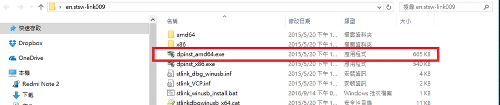

Zt Liu
Senior III
July 12, 2017
Posted on July 12, 2017 at 09:20

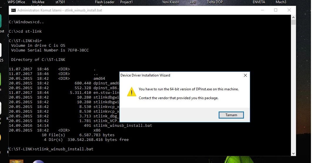

mehmet.karakaya
July 14, 2017
Posted on July 14, 2017 at 13:40
I have added screenshot
Vangelis Fortounas
July 14, 2017
Posted on July 14, 2017 at 13:51
This message is not from bat file.  Is from dpinst_x86.exe.   Try to run  directly with administrator rights the dpinst_amd64.exe

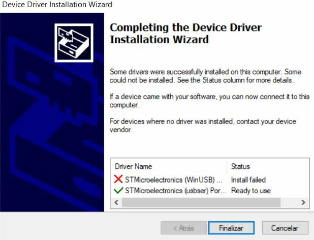

Oscar Lopez
Visitor II
March 21, 2018
Posted on March 21, 2018 at 19:05
Hi
I?ve tried to follow all the considerations mentioned and still have the same error on my Windows10
a) downloaded
http://www.st.com/en/development-tools/stsw-link009.html
b) unzip and run as with administrator privileges the bat file
c) review Device Manager under unknown usb device and try to upgrade indicating to the .inf folder, it fails with '' Device Description Request Failed''
Any ideas?
Thanks for answering
Oscar
Oscar Lopez
Visitor II
March 23, 2018
Posted on March 23, 2018 at 09:31
Thank you all, for sharing the previous posts
Solved!!
In my case it was an inference with the Antivirus Software (corporative) and I had to disable it (surprinsingly , not the rest of the guys of my team making the same instalation, behavoural protection? )
After failed running the .bat file stlink_winusb_install.bat, finally I got it, running directly 'dpinst_amd64'
