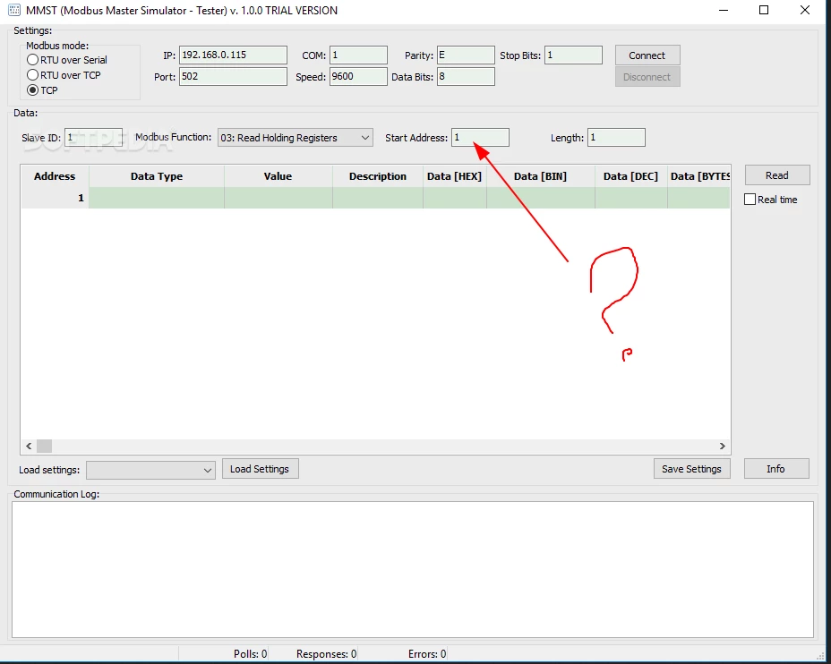

I'm studying a Modbus...

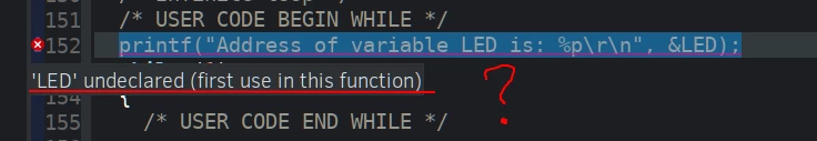

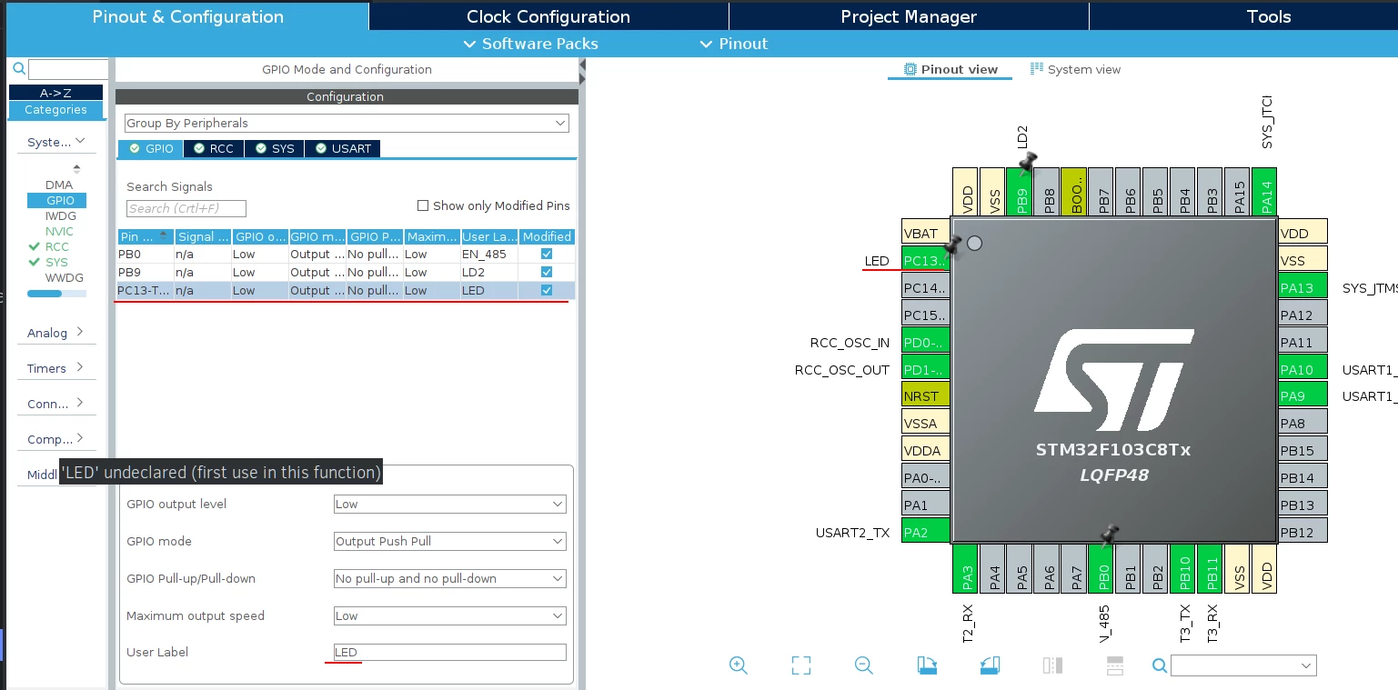

And i wanna to check my code and I want to check the condition of pin PC13 (LED).
How to find out the address of pin C13?
If this line
printf("Address of variable LED is: %p\r\n", &LED);
say to me error "'LED' undeclared (first use in this function)".

There is no address of the LED, LED is connected to a GPIO pins and LED is a define not an address. This define is than argument to several function that manipulate the state of the LED.
DK.7
DK.7Author
January 7, 2022
Thank you for answer! Then how can I find out the condition of LED with Modbus?
I need to specify the start address in the simulator Modbus master.
see screen.
Uwe Bonnes
Chief
January 7, 2022
You need some task in your controller that read the LED state and translates it to Modbus.
