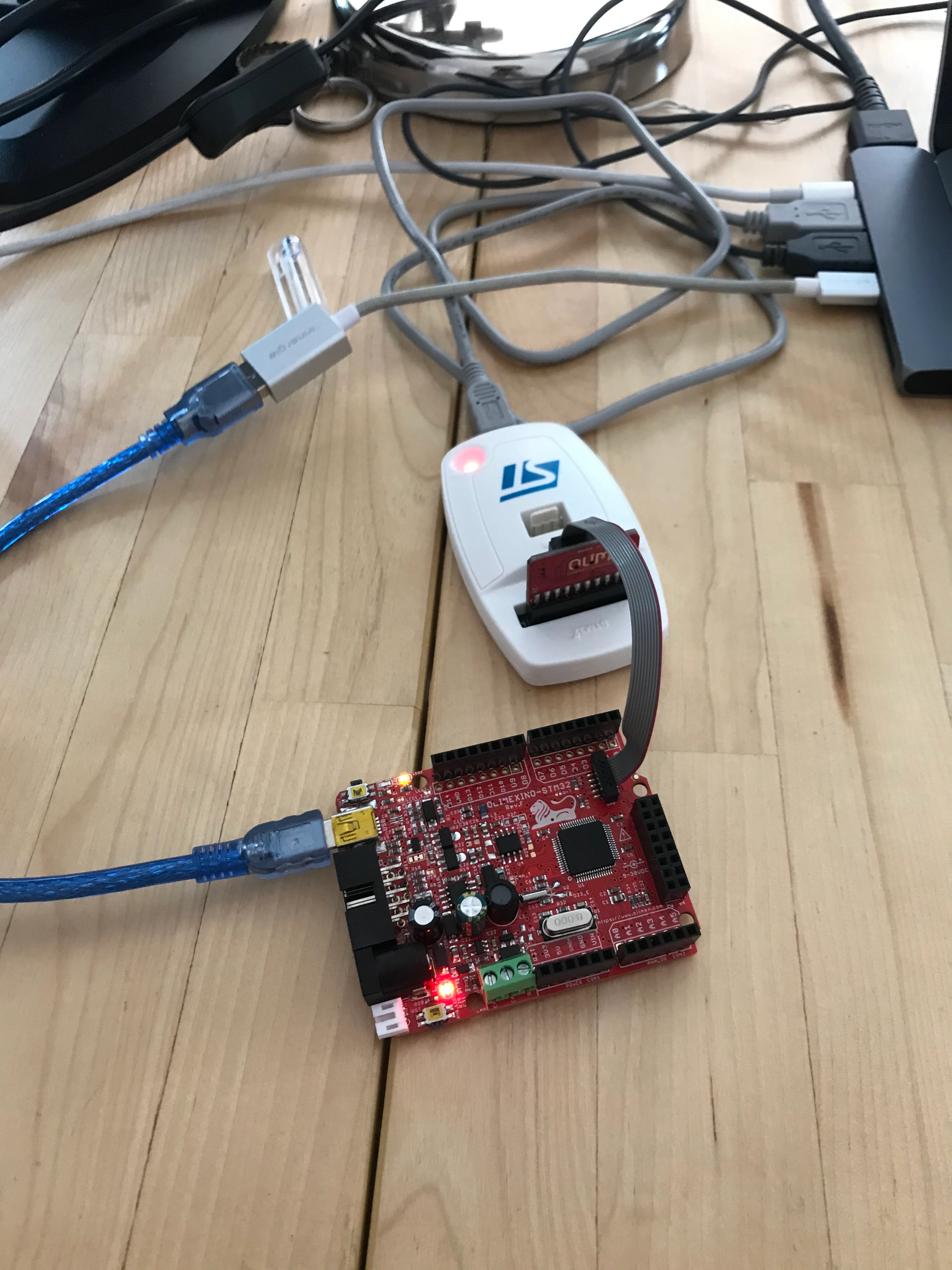

Hello, I realised that there is less than none articles about this topic so I'm looking for advice here. Long story short, I'm trying to communicate with my Olimexino STM32 board with Virtual Com Port. I am using CubeMX to create the source code, and I'm uploding it via ST-LINK Utility with STLinkV2. I try to cummunicate with the board via RealTerm. But, everytime I load any code (even if it's just a simple blinking led) on the board it just stops showing it in the Device Manager. I tried many different ways, and I have read somwhere that it might be a wrong resistor connection problem. I am a newbie if it comes to STM32 so please be gentle. I will be very grateufl for any insight on this topic.

JWojt.1
JWojt.1Author
April 4, 2020
Hi Ons,
I don't know if desribing it would do any good so here is a picture showing my cable connection:0693W000000VK2xQAG.jpg
As you can see I am using one cable to connect the board to the PC with the micro USB port and one cable to use the StLinkv2 with the JTAG cable.
I was hoping that after loading the code on the board I would be able to loose the StLinkv2 and communicate via RealTerm with only cable remaining.
Again, thank you for your feedback.
Sincerly,
Jan
Ons KOOLI
April 10, 2020
Hi JWojt.1,
It seems that your setup is good.
Please refer to CDC_Standalone projects in STM32Cube firmware.
  • "I was hoping that after loading the code on the board I would be able to loose the StLinkv2 and communicate via RealTerm with only cable remaining."
    • I think this is your problem. Can you explain more in details? It is not clear to me.
    • With this configuration you are presented in the picture, and after loading your CubeMX generated project into your board, is your device enumerated by Host ?
Best Regards,
Ons.
