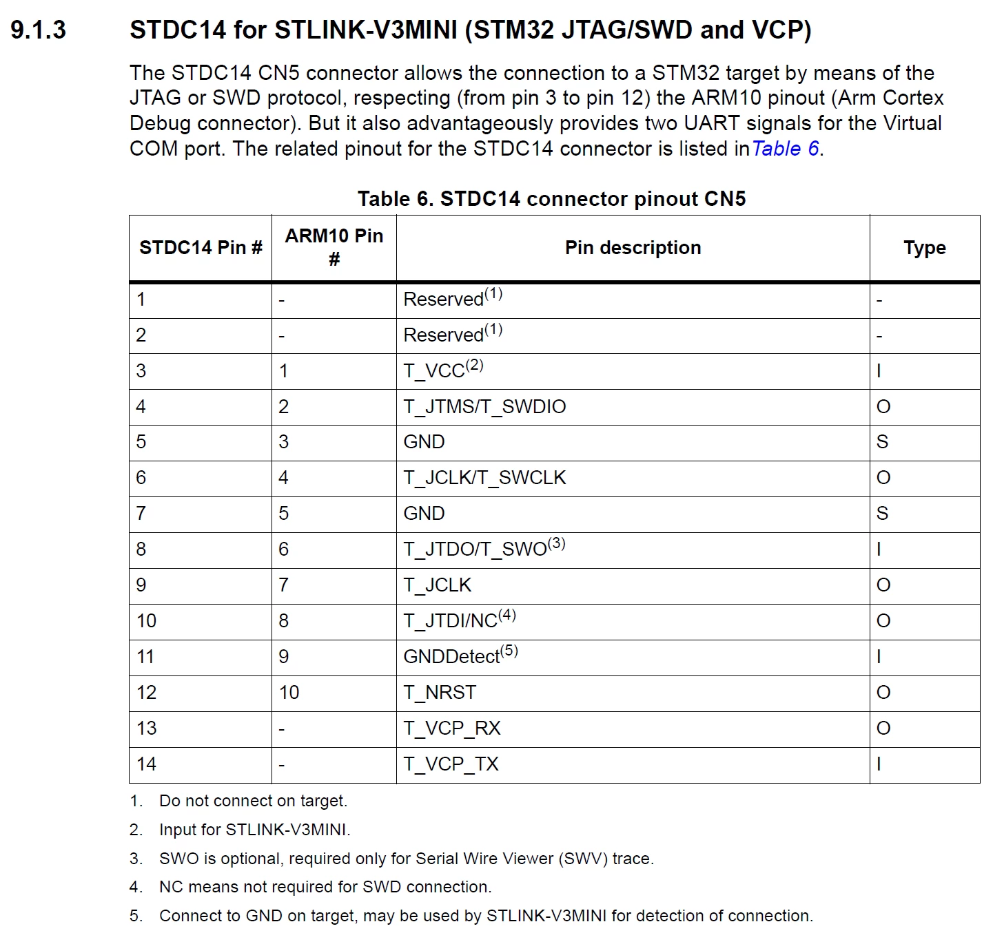

Make it easy on yourself and use a standard connector used by the programmer of your choice.
https://www.st.com/en/development-tools/stlink-v3mini.html#documentation

Put a 14-pin header on your board and connect the signals in the table to the relevant pins on your board. For example, T_SWO is the SWO of the target MCU, which is pin PB3 on your board. T_VCC should connect to the power rail on your board. Note that you will still need to provide the board power.

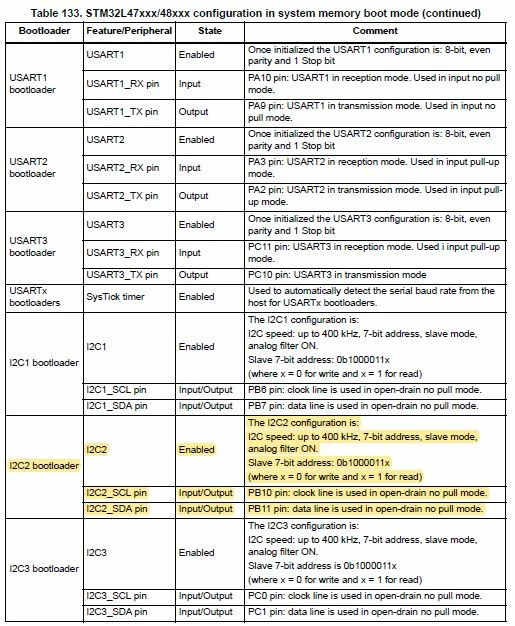

Is there any way I can use I2C to upload the program into MCU?
September 27, 2021
Prajnyajit
September 28, 2021

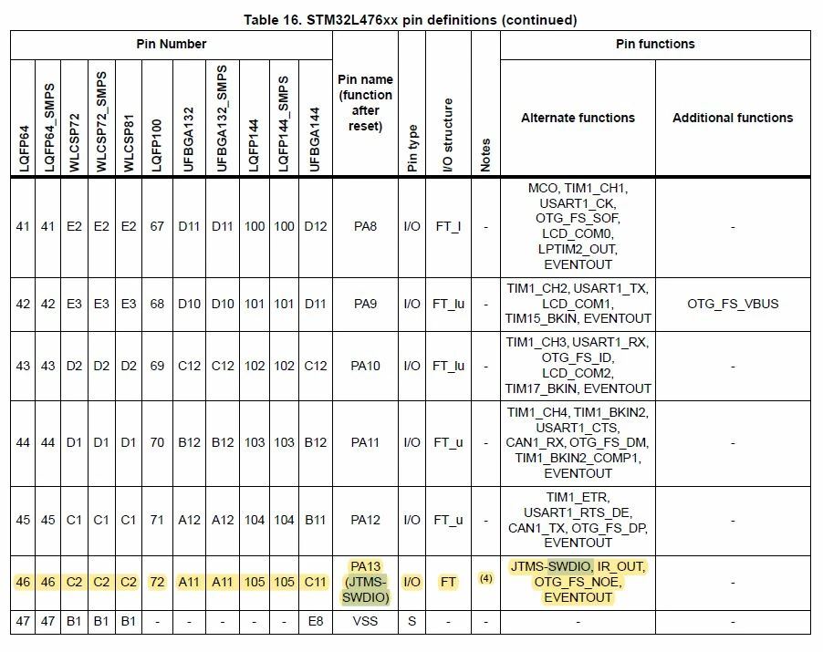

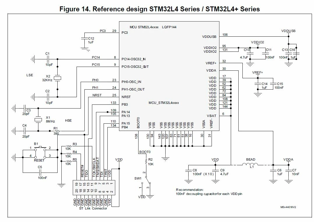

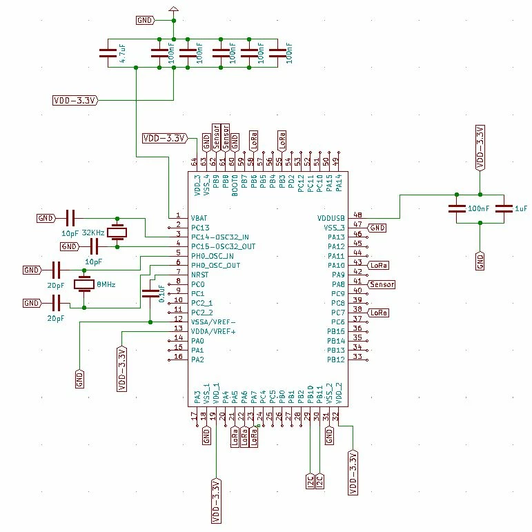

Thanks, TDK. I have followed AN2606 (Page329/417, Table. 133) and understood the I2C connection procedure. I have modified the circuit, it would be very helpful if you kindly verify and let me know whether that is correct or not. As per your advice, I'll go for PCB fabrication.
MM..1
September 28, 2021

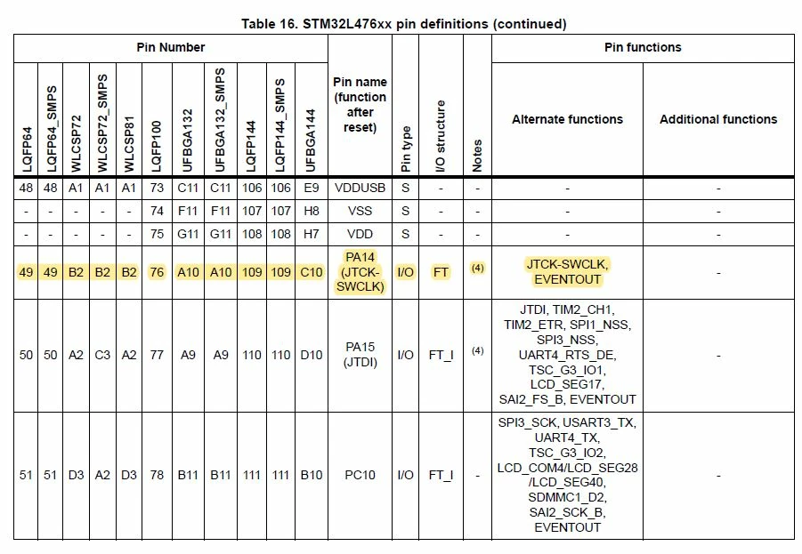

Page 60 datasheet
3.37.1 Serial wire JTAG debug port (SWJ-DP) The Arm® SWJ-DP interface is embedded, and is a combined JTAG and serial wire debug port that enables either a serial wire debug or a JTAG probe to be connected to the target. Debug is performed using 2 pins only instead of 5 required by the JTAG (JTAG pins could be re-use as GPIO with alternate function): the JTAG TMS and TCK pins are shared with SWDIO and SWCLK, respectively, and a specific sequence on the TMS pin is used to switch between JTAG-DP and SW-DP.
Reply for your primary question how load to MCU is place pinheader to your schematics 4pin on your image : NRST , TMS(PA13) , GND, TCK(PA14)
And you can use without complicated bootloders and uart. You connect this 4 wires to STLINKvx pinheader and programmer into USB.

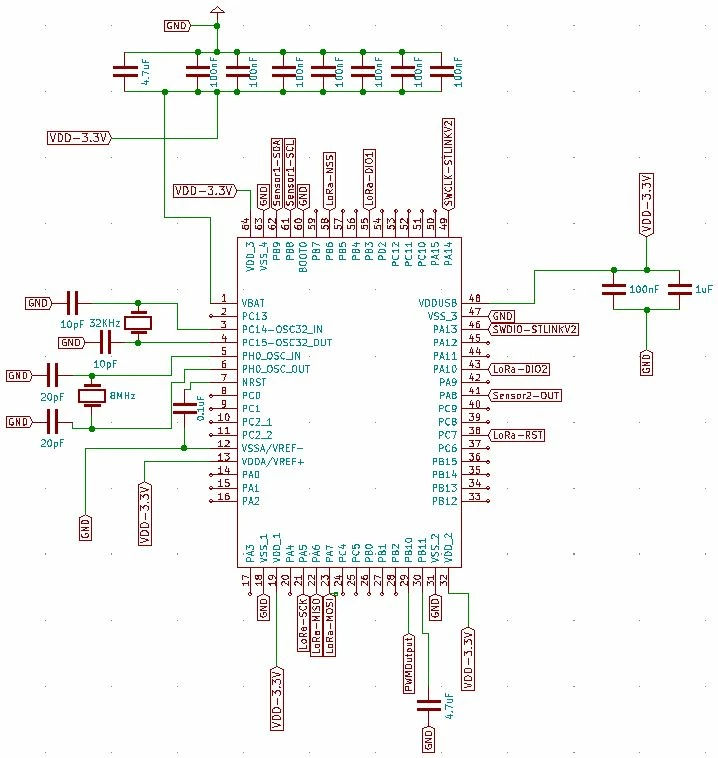

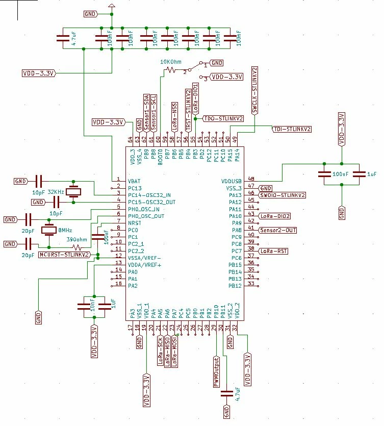

I have modified as per your suggestion please let me know if it is right or not. Here I have made the BOOT0 to GND because I am using JTAG. Will it work?
MM..1
September 29, 2021
If you don’t plan test system bootloader , then BOOT0 to GND , otherwise to GND over R 10k for example.
When your code don’t plan use PA13,14 then SWD will work without NRST then you realy use GND and two wires.
And no NRST isnt connected to TRST...

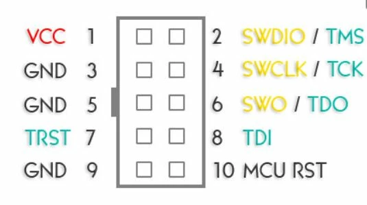

If I use an ST-LINK V2, whose pins are as shown as follows.
as per your suggestion, should I need to connect
  1. NRST (of MCU) to TRSR (ST-LINK V2)
  2. PA13 to TMS
  3. PA14 to TCK
  4. GND to GND
Is it so ? Aksing you to get confirmation. If so, should I pulldown BOOT0 to the ground?
In this way can I debug and upload the program to MCU?

What Pin# on the MCU does pin 7 on the header go to? NJTRST (PB4?)
Pin 10 here should be MCU NRST/NRESET
If you expect your code to run when the board powers up, BOOT0 should be low

0693W00000FApKbQAL.jpg0693W00000FApKlQAL.jpgYes, as per the reference manual TRST which is pin 7 on the header will go to PB4 (Pin 56 of STM32L476RGT6U).
Pin 10 which is MCU RST on the header, will go to NRST (Pin 7 of STM32L476RGT6U).
Ok! I got it, Boot0 will be lowered after the program is uploaded and ready to run. Isn't it?
I have complied with all the changes you have told and attaching the schematic here. Can you please verify?
NOTE: I've another doubt that, I have connected NRST with Pin 10 of ST-LINK V2 and is grounded as per the reference manual screenshot attached. So is it correct or not? Will, it (NRST & Pin 10 of Header) be grounded or not?
