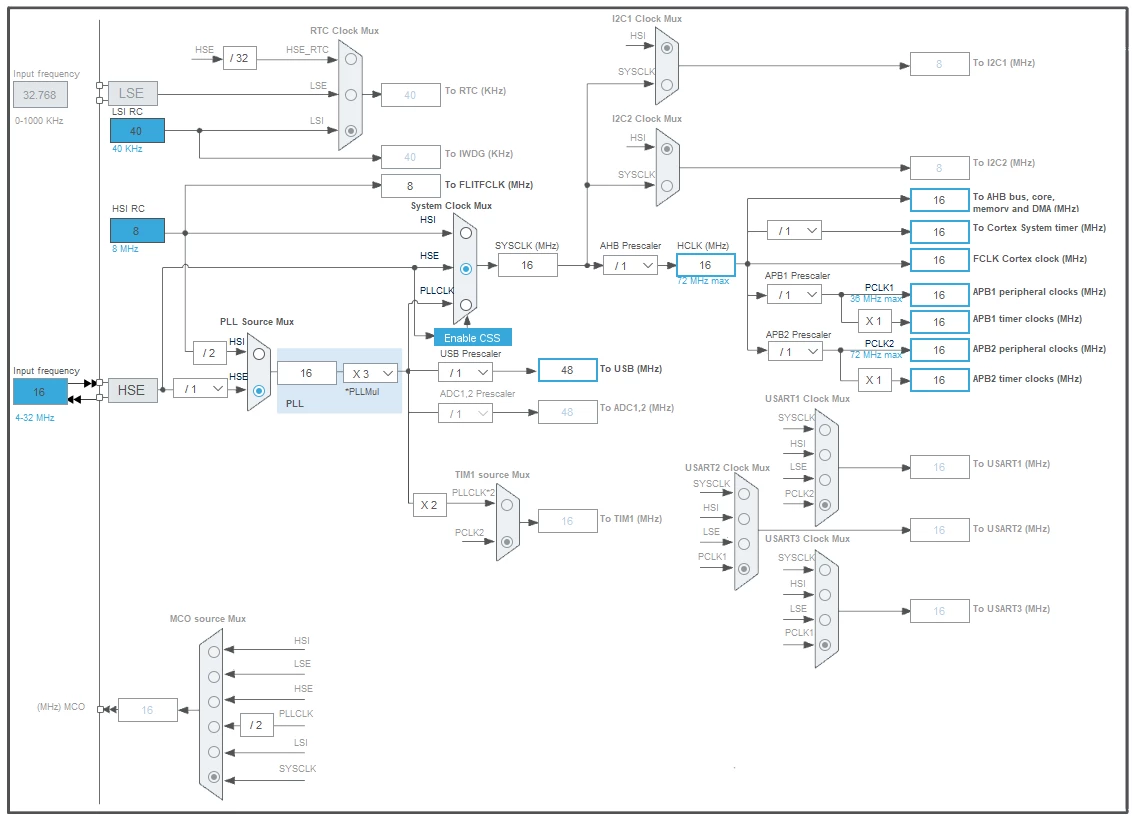

Hello all, I am starting a new project based on the STM32F302 MCU and I am running into an interesting clock configuration timeout issue that results in a fault during most debug sessions. So far, all I have done is configure the clock tree and enabled the USB peripheral as a virtual COM port.
I am using an external 16 MHz oscillator which feeds directly to the system clock. The USB peripheral clock is generated using the internal PLL x3 to 48 MHz.
The System Clock Config function generated is given below:

The timeout occurs in the first snippet:
 RCC_PeriphCLKInitTypeDef PeriphClkInit = {0};
 RCC_OscInitStruct.OscillatorType = RCC_OSCILLATORTYPE_HSE;
 RCC_OscInitStruct.HSEState = RCC_HSE_ON;
 RCC_OscInitStruct.HSEPredivValue = RCC_HSE_PREDIV_DIV1;
 RCC_OscInitStruct.PLL.PLLSource = RCC_PLLSOURCE_HSE;
 RCC_OscInitStruct.PLL.PLLMUL = RCC_PLL_MUL3;
 if (HAL_RCC_OscConfig(&RCC_OscInitStruct) != HAL_OK) // RETURNS HAL_TIMEOUT
 Error_Handler();
The timeout occurs about 80% of the time, and I can not get the device to register as a virtual com port at all. I have a very similar setup running on a STM32F405 with no issues. I have included the external pullup since it is required by the F302.
Do any of you have any wisdom as to what is going on here? I have the same code running on another part number just fine.
Thank you!
Matthew

RCC_OscInitStruct.HSEState = RCC_HSE_BYPASS; // Not required to need starting or wait for it to come ready

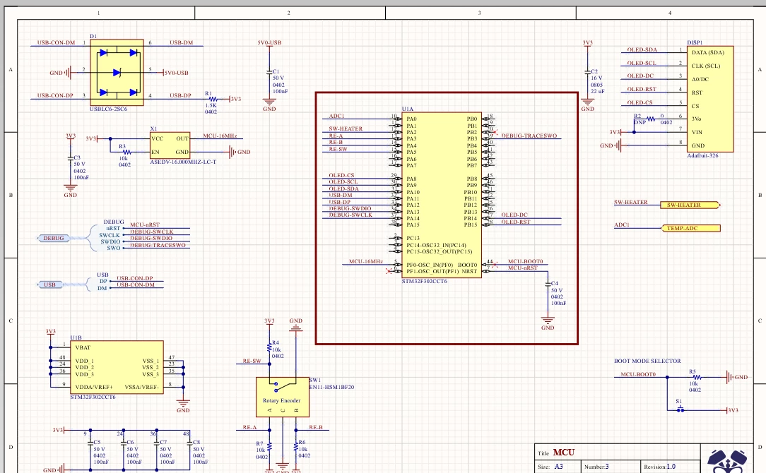

Is this a custom board? You could dig into HAL_RCC_OscConfig to find the reason. Probably the HSE is never going stable, which would suggest a hardware error.

Hi TDK, thanks for the reply. Yes, this is a custom board, but the external oscillator setup is very similar to other boards I have made that work reliably. I have also looked at the oscillator output on an oscilloscope and everything looks good.0693W00000ANM2yQAH.png

External oscillator? Should RCC_HSE_BYPASS be used?

Hi Tesla, yes I am using an external oscillator. I am still a little inexperienced with this, could you clarify what RCC_HSE_BYPASS does, and where you think it should be used? Thanks!
May 5, 2021
> Can I ask, what is the reason that this option is preferred?
If you have an external clock source that doesn't need driven by the chip, and only one pin is connected, you should select bypass mode.
If you have a crystal that needs driven, with both OSC pins connected, you need normal HSE mode.
