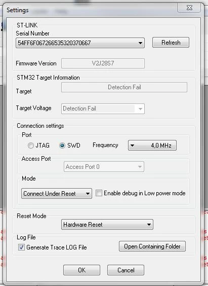

Iam currently unable to connect to my STM32L476 Discovery board using an ST-Link.
I have removed jumpers from CN3, connected the cables correctly but the utility tool won't detect anything...
JP3 is ON, JP5 is on Idd OFF and JP6 is on 3V3.
Here are the connection between my ST-Link/V2 and my board :
PIN1 -> 3V3
PIN7 -> SWDIO
PIN9 -> SWCLK
PIN15 -> NRST
PIN20 -> GND
The STM32L476 discovery board is powered by an external supply (connected to 5V_I).

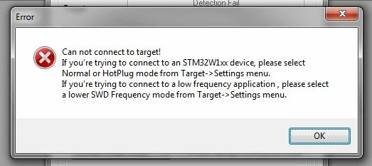

Here is what I get from STM32 ST-LINK Utility :
I got the error :
ST-Link/V2 device detected
Target voltage detected: 3.252984
Driving NRST low
Error getting target IDCODE: if SWD, check SWD connection
Error (4) while initializing ST-Link in SWD mode
I tried every SWD frequencies possible.
I also powered Vapp (on discovery board) with 3.3V (not sure if I have to or not, so I tried both).
Thank you for your help.

To the specific pins of the L476, or the SWD header from the onboard ST-LINK? The header isn't going to work.
Make sure NRST is disconnected from the onboard ST-LINK, may require a solder bridge being removed.
Why? Does the onboard ST-LINK not work?

It's connected to the SWD header from the board, because specific PIN (PA13 and PA14) are note visible (there isn't anything to connect these pins). Why it isn't going to work ?
The on-board ST-link works, but I am planning to make my own elctronic card, based on the micro-processor on this discovery card. When producing card in huge quantites, code is not transferred via USB, but via JTAG or SWD. Then, I would like to be sure that programming via SWD works.

The SWD header is on the wrong side of the CN3 jumpers, review the schematic.
You'd want to connect SWDIO/SWCLK to the L476 side of the CN3 jumper pins
