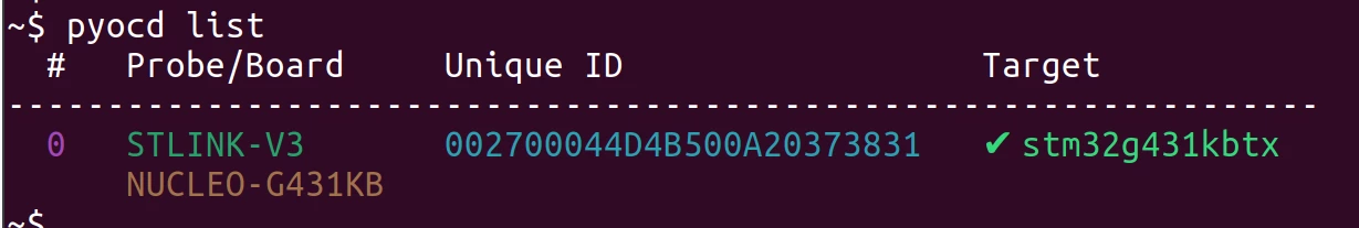

Hi thank you, I want to use pyOCD but I really do not understand the doccumentaion:
1) How to check if any MCU is connected to the STlink? Would be great if it returns me specifi name of the MCU like STM32F303RBTx
  • I tried pyocd status, but it returns: pyocd: error: unrecognized arguments: --status
really do not why it does not know command status
2) I Want to erase and flash MCU
  • I used pyocd erase --chip -t STM32F303RBTx - it works
  • I used pyocd flash -t STM32F303RBTx tester_wallbox_power.bin
3) I want to read and write to the specific memory location
There is list of all commands, which I found: https://pyocd.io/docs/command_reference.html
Can you help with it please?

Sometimes an STLink is able to identify the chip it is connected to, and sometimes not. I think it only works for STLinks that are embedded into a dev board, like one of the Nucleo boards.
For instance, I have an NUG431KB Nucleo board. When I plug it into my computer via USB (and thus am using its embedded STLink), I can get the following:
pyocd pack install stm32g4
# Lots of output, errors and warnings are usually fine
pyocd list
# Probe/Board Unique ID Target
# 0 STLINK-V3 002700044D4B500A20373831 ✔︎
# stm32g431kbtx
# NUCLEO-G431KB
