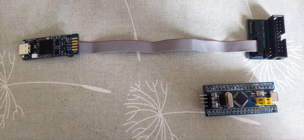

How to connect STM32F103C8T6 to STLINK-V3MINIE
I recently bought a Blue Pill, STLINK-V3MINIE and an adapter. How do I connect them together correctly?

Dear @hafiqat_ ,
You need just to connect/hook the SWD connector signals from the ST-link to the target : VDD, Ground , SWD and CLK
Hope it helps you , pay attention on the orientation of the cable to not Have short circuit on both VDD/Ground .

hafiqat_Author
March 23, 2025
Do I just need to solder the contacts to the stlink? Without using an adapter?
STOne-32
March 23, 2025
Yes you can for development purposes .
hafiqat_Author
March 23, 2025
Where to solder SWDIO?

 ST-Link
| Vtarget +<-------------------------+-----VDD
| SWDIO +<------------------>+SWDIO |
| | | | STM32 Target
| SWCLK +------------------->+SWCLK |
| NRST +------------------->+NRST |
| | | | | | +-----+-----+ | | | | | | | GND +--------------------------+-----GND | | +-----------+
