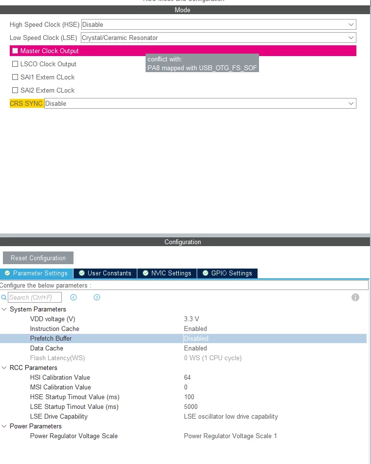

How to configure RCC in STM32 Cube using NUCLEO-L496ZG and on board crystal resonator
  • February 10, 2023
  • 1839 views
I entered an inifite loop at the HAL_RCC_OscConfig (l 29) of SystemClockConfig() ​
void SystemClock_Config(void)
 if (HAL_PWREx_ControlVoltageScaling(PWR_REGULATOR_VOLTAGE_SCALE1) != HAL_OK)
 Error_Handler();
 /** Configure LSE Drive Capability
 HAL_PWR_EnableBkUpAccess();
 __HAL_RCC_LSEDRIVE_CONFIG(RCC_LSEDRIVE_LOW);
 RCC_OscInitStruct.OscillatorType = RCC_OSCILLATORTYPE_LSE|RCC_OSCILLATORTYPE_MSI;
 RCC_OscInitStruct.LSEState = RCC_LSE_ON;
 RCC_OscInitStruct.MSIState = RCC_MSI_ON;
 RCC_OscInitStruct.MSICalibrationValue = 0;
 RCC_OscInitStruct.MSIClockRange = RCC_MSIRANGE_5;
 RCC_OscInitStruct.PLL.PLLState = RCC_PLL_NONE;
 Error_Handler();
 RCC_ClkInitStruct.SYSCLKSource = RCC_SYSCLKSOURCE_MSI;
 RCC_ClkInitStruct.APB1CLKDivider = RCC_HCLK_DIV1;
 RCC_ClkInitStruct.APB2CLKDivider = RCC_HCLK_DIV1;
 if (HAL_RCC_ClockConfig(&RCC_ClkInitStruct, FLASH_LATENCY_0) != HAL_OK)
 Error_Handler();

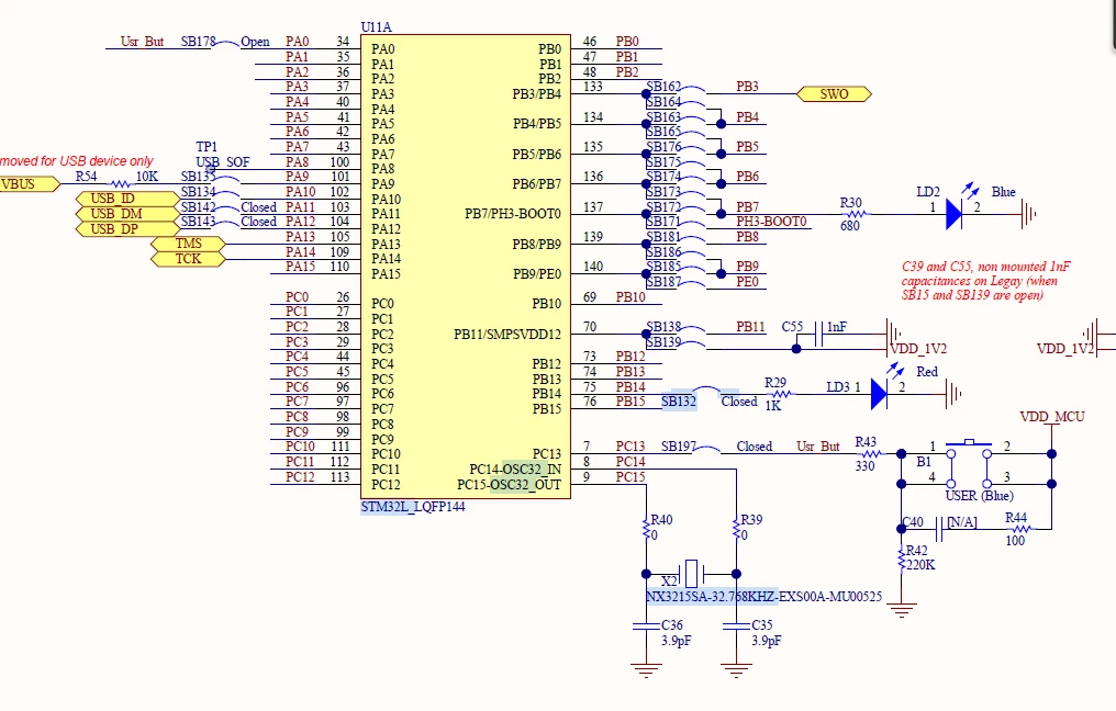

I thought this cause bay be the setting of the RCC configuration mismatch actual board (STM32L496 demo board: NUCLEO-L496ZG) ,but I can't find correct configuration setting on condition of using on board crystal resonator X2.0693W00000YAQIWQA5.png

Hello @DKusa.1​
In the initialization of RCC Oscillators, it seems your PLL is not configured!
To give better visibility on the answered topics, please click on "Best answer" on the reply which solved your issue or answered your question.Best regards,FBL
AScha.3
February 10, 2023
set LSE drive to high .
