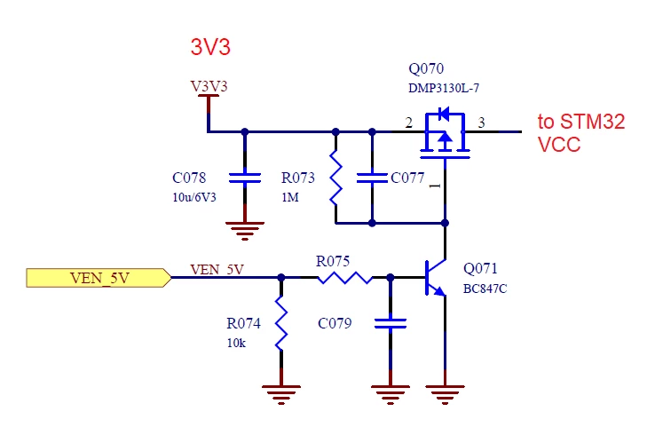

How should I do a power cycle?
Which Pin should I set and reset to make a power cycle happen in STM3G4 or any popular STM32F3xxx.. ??
I have 2 mcu's and with one of it I want to do a power cycle..
I mean to remove the power and connect it again. What should I do here?

Power cycle requires you to remove power which will vary based on how your chip is powered. It may not be possible to power cycle the chip independently of other things on the board. You haven’t provided any details about the hardware you’re working with.
Toggling NRST will reset the chip.

Toggling Reset will do system reset.
I need a power on Reset, trying to find ways to do it. But really couldn't find out.
And I am using STM32f302vc now.
January 17, 2022
Power cycle isn’t a software thing. You need to remove power. How you do that depends on your hardware board, which you still haven’t provided. For example, if power is coming via the usb cable, you would need to remove and reply the cable to cycle power.

...or the pin-controlled switching off of the supply voltage via e.g. a transistor.

Do you mean that one of the two controllers stays "alive" and can power down the other controller?

Yes. This is my target.
And I should implement this. Not implemented yet.

Then you need some more hardware, most importantly a P-channel MOSFET.
Something like this, although when switching 3V with 3V IOs you can leave the npn.
