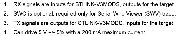

How much power can an stlinkv3 mods deliver on its 5V? It is stated nowhere on the datasheet

in mine i can see: 200mA

Thank you, that was definitely my problem then :grinning_face_with_sweat:
