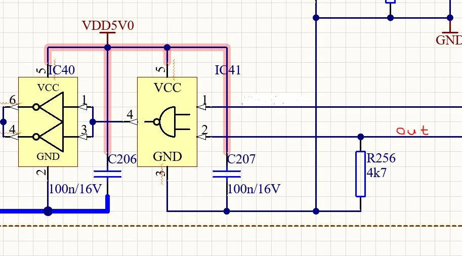

How do I have to configure the standard debug PINS (PA13 and PA14) on STM32F030F4P6 if I want to use them as GPIO output?
  • November 29, 2021
  • 4 replies
  • 7077 views
Currently I only set the MODER register to 0 and set the outputs to 0 with the BRR register since I don't need further configurations. I allready use other PINs with the same configuration and they work. I read that this should work, but on my HW it doesn't.

What does it mean exactly: "this should work, but on my HW it doesn't", i.e. what output levels do you get?
What else is connected there?
  • I read in the community that setting the pin as output should work
  • the output is zero
waclawek.jan
November 29, 2021
> After every reset i set them as output with the MODER register.
How, exactly?
PCana.1
PCana.1Author
November 29, 2021
((RCC->AHBENR) |= (RCC_AHBENR_GPIOAEN))
((GPIOA->MODER) |= (GPIO_MODER_MODER14_0))
((GPIOA->MODER) |= (GPIO_MODER_MODER13_0))

waclawek.jan
November 29, 2021
As PA13 and PA14 are set to AF after reset, i.e. 0b10, this sets them to 0b11 i.e. Analog, not Out.
PCana.1
PCana.1Author
November 29, 2021
that sounds legit. I will test it later:)
Thank you very much!!
