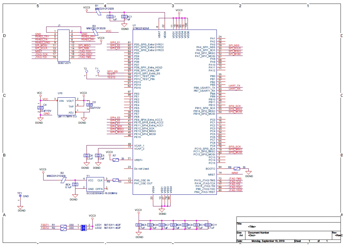

How do I fixed it? "init mode failed"
Dear, you
About 6 month ago, I join class for ARM core.
It very interesting for me.
So I made customized PCB with STM32F429ZI Core.
Before when I made customized PCB, I study for nucleo board.
I testing my made PCB Board, I look problems.
The test environment is below:
Computer : windows10 Home x64
Program : System Workbench for STM32
Debugger : ST link V2
Error MSG
Info : Listening on port 666 for tcl connections
Info : Listening on port 444 for telnet connections
Info : clock speed 8000 kHz
Info : STLINK v2 JTAG v34 API v2 SWIM v7 VID 0x0483 PID 0x3748
Info : using stlink api v2
Info : Target voltage : 3.206299
Error : init mode failed (unable to connect to the target)
in procedure 'init'
in procedure 'ocd_bouncer'
I generated code, used CubeMX.
Debugger used JTAG port(20pin).
I already tried STM32 ST-LINK Utiltiy, but situation is same(ST-Link V2 Firmware update included).
I don't konw why this happend, and It make me crazy.
Anyone help me please.
If anyone want to see a schematics, I'll upload.
Thank you.

Check voltage present on NRST and VCAP pins

Here my schematic capture files atttached.
NRST Pin check oscilloscope
Power on : NRST near 0 voltage
System Workbench for STM32 program debug image click : NRST near 3.3 voltage
You'll see about a VCAP.
In my schematic, VCAP1, VCAP2 is conneected GND.
