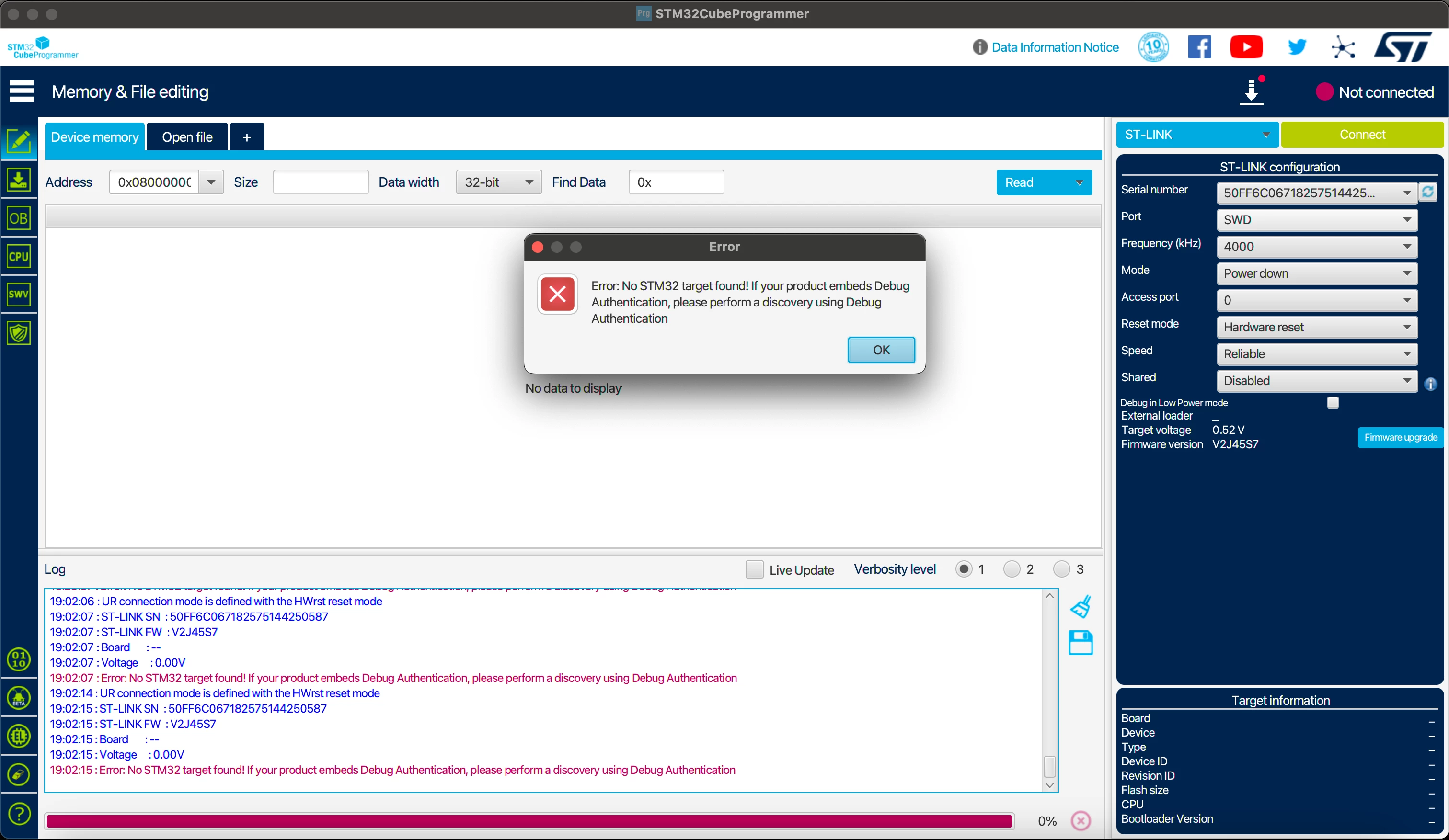

I encountered this error when I was trying to flash my custom board with fresh stm32F070C6T6. I used st link v2 for debugging. I updated the firmware of st link v2 right before debugging.
NRST floating, BOOT0 connected to 3V3 -> failed (in any mode)
NRST floating, BOOT0 connected to GND -> failed (in any mode)
NRST connected to GND, BOOT0 connected to 3V3 -> failed (in any mode)
NRST connected to GND, BOOT0 connected to GND -> failed (in any mode)
I also tried both on Windows and Mac(m3), and was not successful.
I also tried Cube IDE, Cube Programmer, and st link utility, but all did not work.
I also tried to use DFU, but it also failed. (no dfu detected)
I measured the voltage to be 3.16V and ensured the wiring was ok.
Now, I have no idea what I should do to fix this issue. Can anyone point out where it went wrong?

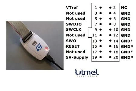

Show current wiring, your picture before looked to mirror required connectivity.
The diagram is for the pin header. The face of the connect is reversed/mirrored. Pin one on the cable is Red at both ends.
The ST-LINK needs pin 1 to be the VTarget and this is used and measured when communicating with the part. Need to see it correctly reported in Cube Programmer.
The part also needs to be electrically viable. Check part orientation. If it's not viable no methods will work.

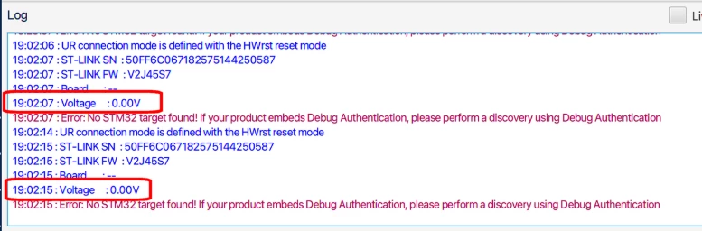

But your ST-Link measures 0V - so something there isn't correct:
Hence importance to show schematics!

+ Your target voltage is at 0.52V:

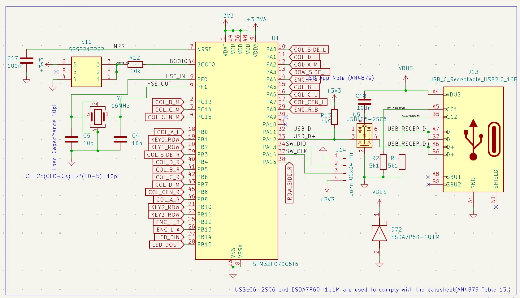

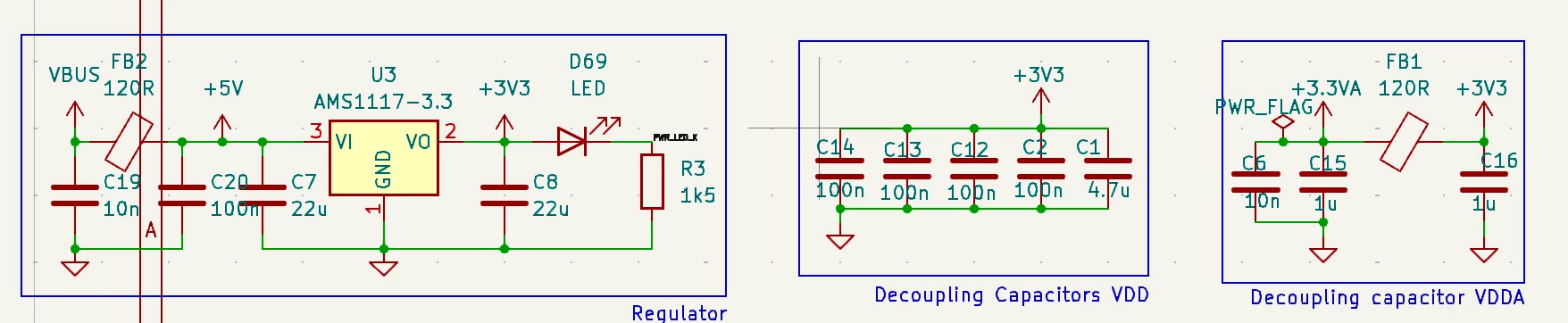

These are my schematics.
I am creating a custom keyboard. Almost all pins are connected to switches.
I noticed that I made a mistake in the switch which was supposed to switch the state of the boot0 pin, so I'm manually connecting the boot0 pin.

According to that schematic, your programming header's pin 4 connects direct to your +3V3 supply.
So how & where, exactly, did you measure 3.16V ?
Note that it's always good to include NRST on your programming/debug header - as that can get a connection when the SWD pins are disabled ...

Edit: when I measured the voltage of the regulator, it was like 2.8V for 3v3, and 1.8V for 5V…
I assume the regulator is working fine, since when I measured the voltage when the usb type C is plugged in, those voltages were just fine. (about 3.2V and 5.1V)

YES, you were absolutely right, I mirrored it, just like @Mike_ST showed me on the picture, and it worked!!!!
