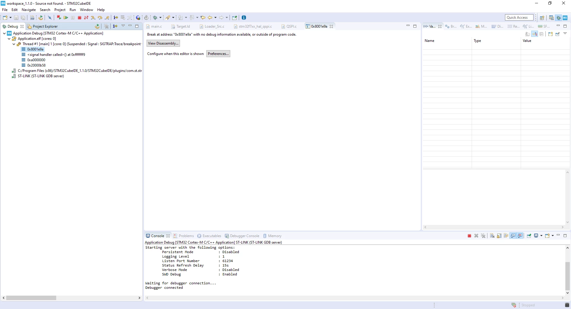

I'm developing an application with an STM32F750Z8 and I need to put the code in the external flash and then debug it.
I tried to implement the firmware:
1) I created the Launcher with STMCubeIDE and STMCubeMX and programmed the microcontroller with them. This application perform only a jump and a led blink if enter in HardFault.
You can find the Launcher in attached (is with IAR because is a old project but there should not be any problems or differences).
2) I implemented FlashLoader, following the guide https://www.st.com/content/ccc/resource/technical/document/user_manual/e6/10/d8/80/d6/1d/4a/f2/CD00262073.pdf/files/CD00262073.pdf/jcr:content/translations/en.CD00262073.pdf at 3.9 chapter and based on the example in N25Q512A_STM32F769I-EVAL path of STM32 ST-LINK Utility/ST-LINK Utility/ExternalLoader directory (inside STMCubeIDE directory there are no examples for STM32F7): I created the FlashLoader with STMCubeIDE and configured the STM32F750Z8 (it's microcontroller for my application) with STMCubeMX; I added the files in N25Q512A_STM32F769I-EVAL, added my custom library for QSPI (the QSPI.c and QSPI.h files) and all the HAL libraries necessary and set the proper linker file (Target.ld).
I compiled, modified the extension of "elf" file in "stldr" and I moved this file in ExternalLoader directory of STMCubeIDE.
You can find the FlashLoader in attached.
Step3) I implemented an empty application with STMCubeIDE and STMCubeMX and tried to change "External loader" in Debug Configuration -> Debugger.
First of all the file that I copied in 2) doesn't appeare when I click Scan. If I insert manually the name of "stldr" file, the debug starts (I'm using ST-LINK V2) but is not able to debug code and indicates "Break at address "0x8001e9a" with no debug information available, or outside of program code."
In attached you can find a screenshot and application.

The loaders are not normal applications, but rather object files loaded into RAM, this doesn't get done in a way that lends itself to step by step debugging. You can use other peripherals and things like the serial ports to get telemetry. You should exercise the loader in a test application framework you can debug in more normal ways.

>>Ok but also if the code run in RAM I can't debug it? I tried this, it works and the debug start in "init" function.
It is one of these chicken-egg situations, how do debugger writers debug debuggers?
Yes, going to use Init() as the entry point.
You'd need to build a test framework (wrapper), as an app with main(), etc and then call and exercise the loader functions, starting with Init() and then calling the other sub-functions. Debug this in an environment you are comfortable with, and use a BSP you have already tested *thoroughly*. You can use a UART or GPIO, or anything else in your system, to provide diagnostic or telemetry output while working blindly inside the STM32 programming tools themselves. ie to establish why a specific usage is failing, absent the need/ability to single-step everything.
>>Are there specific guides?
No, I think we're expected to know what we're doing. These type of loader have been around for a long time, across a lot of platforms. The ST design is derived from the Keil FLM design, perhaps see if that has better documentation or guides.

In GNU/GCC the memory space is cleaned via code in startup.s or constructors called via __libc_init_array, and in Keil via __main
This doesn't occur in the loaders, as the tools just load the ELF section objects directly into RAM, as is, and call the functions.
There's nothing to unpack the Load Regions, so don't use them. Build instead like you would a DLL, or executable on a PC.
Avoid the ">RAM AT> FLASH" type stuff.
Loss of debug connectivity will occur if the pins are reconfigured or the device sleeps. You can't use interrupts and SysTick. Generally your system with use the vector table currently in FLASH, so if you have a Hard Fault routine that outputs useful information to a serial port you can understand what went wrong.
I have posted several .STLDR examples with different pin configurations, and can remap a lot of the ST provided ones.
The STLDR for the STM32F746G-DISCO and STM32F7508-DK are materially very similar.
Would need to know parts-n-pins to generate one.
