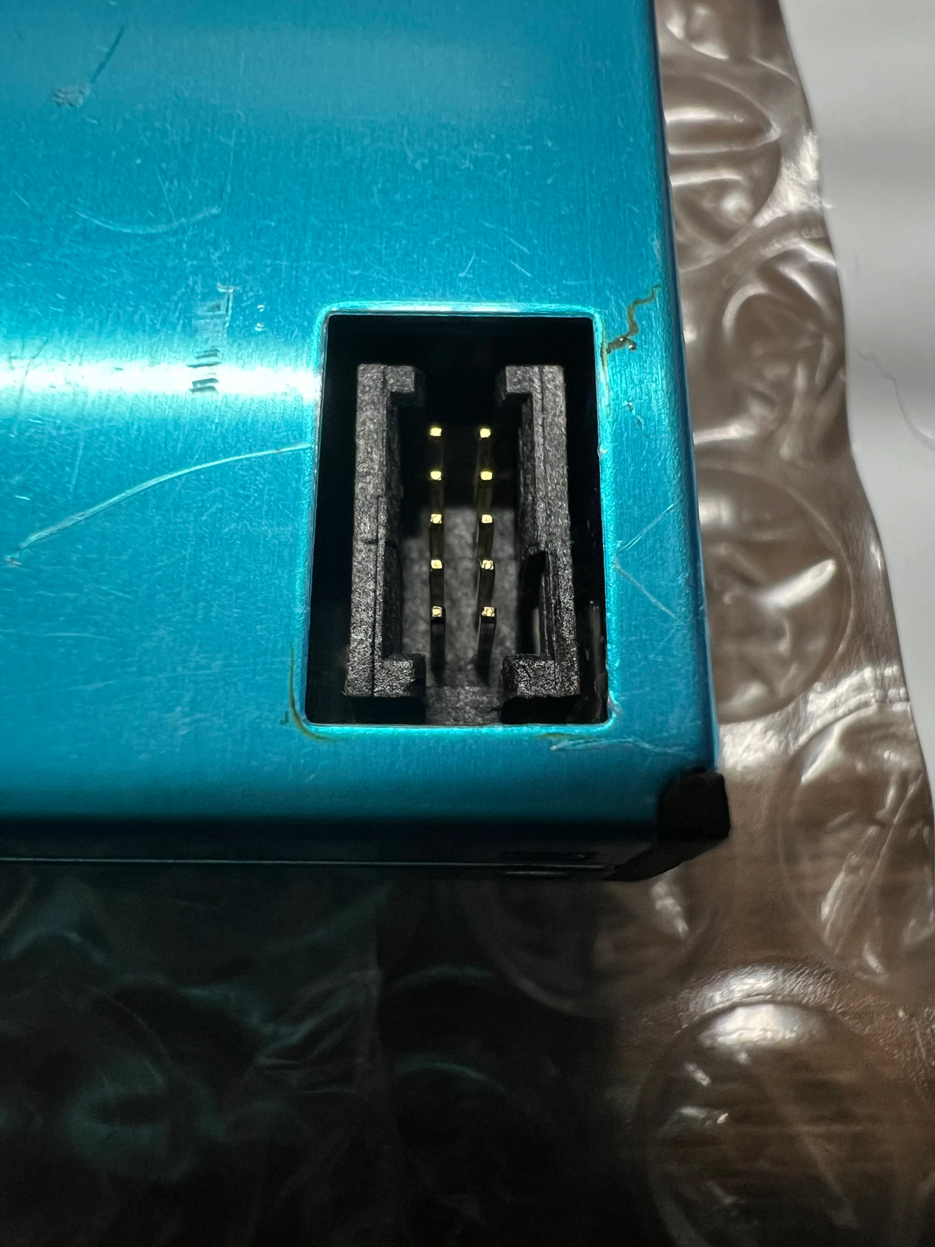

I am trying to establish communication between an SM-UART-04L dust sensor and an STM32F411RE MCU. The output of the sensor (attached image below) does not use the regular sized jumper wires that connect to the MCU and has a 2x5 pin configuration of smaller pins. Is there a specific wire/connector I have to use in order to establish the physical connection with the STM32 MCU? I've consulted the data sheet of the sensor but couldn't find any helpful information regarding the output port.
Any help is appreciated, thank you!
Output port of sensorOutput port of sensor

https://www.tti.com/content/dam/ttiinc/manufacturers/amphenol/AdvancedSensors/PDF/AAS-Telair-Particulate-Sensor-Application-Note.pdf
Describes connector and pins on the connector
You could perhaps find the matching SMT connector, and solder wires to the feet of that?
Perhaps you need different jumper wires?  https://schmartboard.com/2mm-to-0-1-inch-header-converter-923-0001-01/
