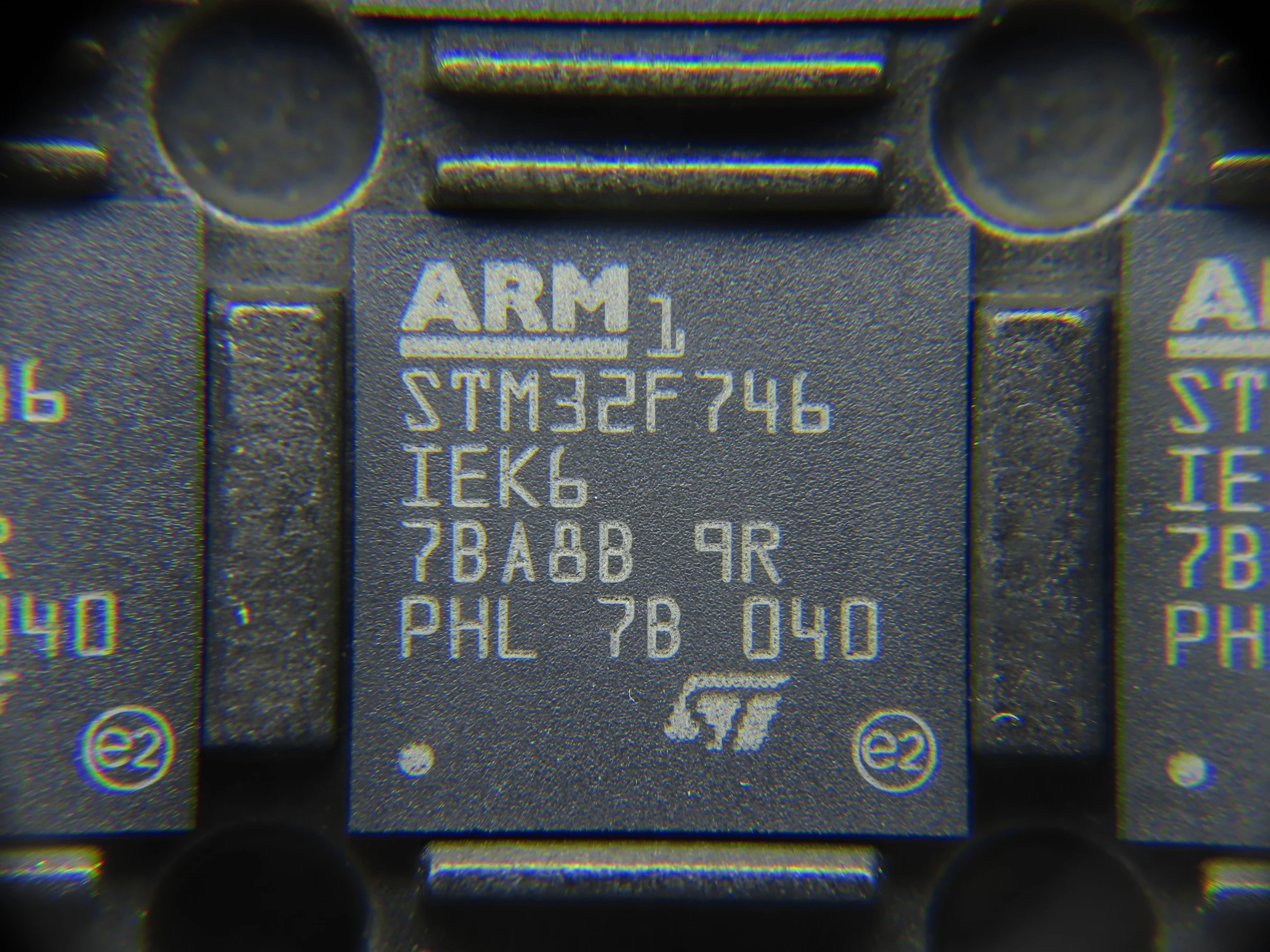

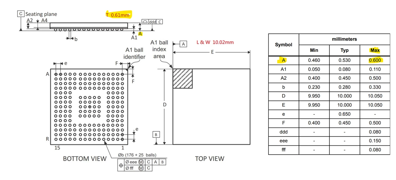

HI, STM32F746IEK6 MCU dimension in the datasheet, The A value should be between 0.460mm and 0.600mm, but we measured several pieces all excess 0.6mm, Our measurement results are 0.610mm, is within an acceptable range?

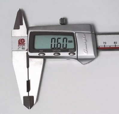

We used electronic digital caliper,We took 30 samples from one package,But most of them measurement results are 0.610mm,Small measurement results are 0.600mm,We want to know is within an acceptable range?
The electronic digital caliper like this
