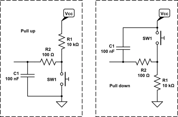

HI i write a code to toggle LED with button by EXTI. when i press the button led turn off and again turn on automatically . I don't want the Led status to change until I press the button again.

Learn what is the physical phenomenon of key debouncing first.

I use this method but nothing changed.

it won't help. Either you check the key status every say 10msec and once confirmed 3 times, consider the level valid, or trigger a timer delay on EXTI to few msec (which an RC filter won't achieve) to double check. This is something you can find code example easily anywhere. I use up/down counter, up if same level (up to a threshold) and cleared as soon as the level is different. A method like many others which will do a debounce.

I used the timer, there was no change. I think the microcontroller is broken.
The main problem is that the gpio status is not saved. And as soon as the routine is over, it returns to its previous state. Even setting a delay has no effect when the LED is on
