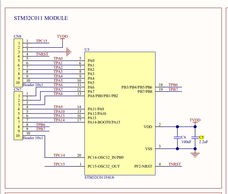

Hi, I have the STM32C011F6-DK and I am wondering if somebody can tell me what sizes the capacitors C5 and C6 have and to which pins these capacitors are connected to. Regards, kawi73

Schematics : https://www.st.com/resource/en/schematic_pack/mb1684-c011f6-b01-schematic.pdf
0693W00000Y9ILuQAN.pngDecoupling capacitors on the single power supply on the DIP20 adapter it seems.

Many thanks. I will have a look to the schmatics.

Schematics and Bill of Materials should be under the "CAD Resources" tab of the assorted DISCO/DK, NUCLEO and EVAL boards
