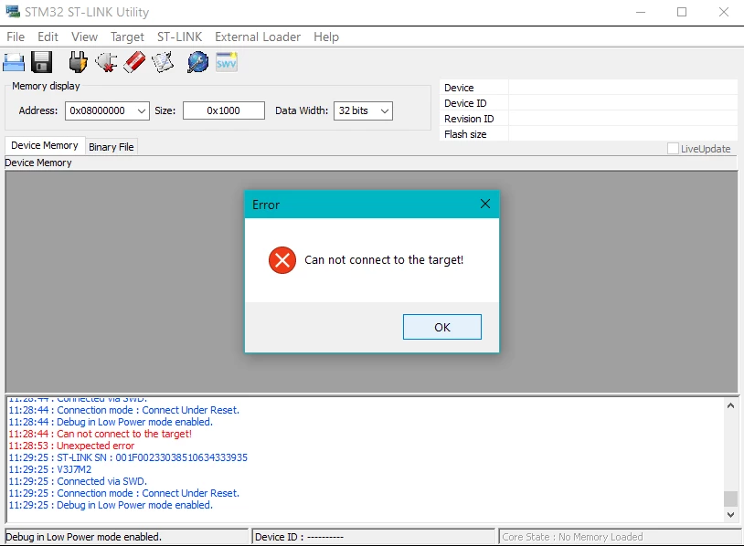

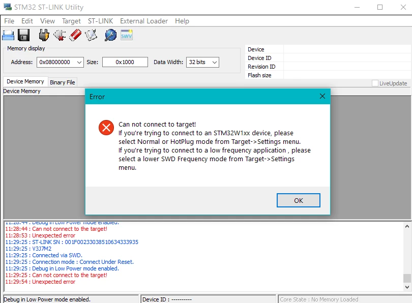

Hi, I bought a NUCLEO-H7A3ZI-Q, and I updated the firmware, from that on, I cant connect to the target whatever I do.
0693W00000QMSAlQAP.png0693W00000QMSAHQA5.pngThe port is showing in device manager and I can update/downgrade the firmware but I cant flash it. I had some similar problem with a bluepill but I put BOOT0 on 1 and erased the chip. After that it worked. I did the same with this board but it tells me cant connect to the target. I tried also with connect under reset. Nothing works...

Don't use ST-LINK Utilities, want to be using STM32 Cube Programmer
If you get the LDO/SMPS settings messed up I'd suggest the following methodology for H7's
Put a jumper on board so you can pull/drive BOOT0 high. The NUCLEO-144's have VDD/BOOT0 pins next to each other to help facilitate.
With the jumper on power cycle the board a couple of time, complete disconnect USB, and reattach, do this twice counting out 5 seconds at each step.
Then when finally reconnected use STM32 Cube Programmer to Erase chip.
Remove jumper
Fix your code
Proceed

you are god, I will call you master Tesla DeLorean from now on. Jesus, I never thought to disconnect and reattach the board. Also yes, using ST LINK utilities was a mistake, thank you so much!
