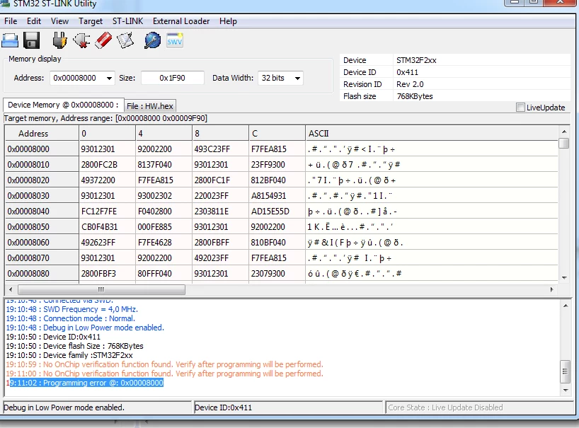

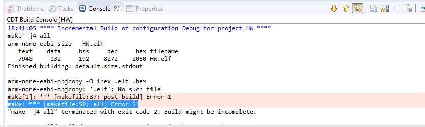

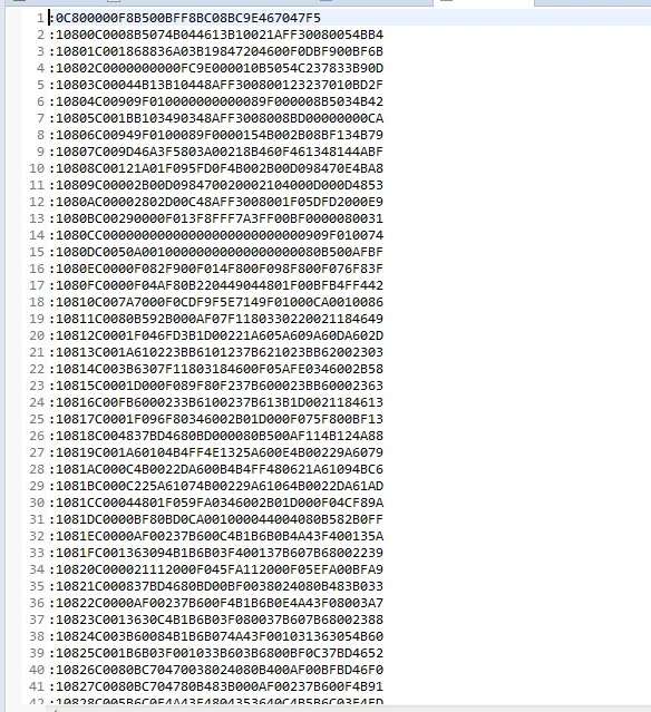

Hi i am trying to load .hex file in my MCU using ST LINK Utility but i am getting the following error
I checked the base address in linker script and its matching with the one in ST link utility. Below are the attachements of ST link utility ,STM32CubeIDE Console and hex file

Application has the wrong parameters, lacks a full file name.
The address is wrong, there is no flash memory at 0x8000, it starts at 0x08000000
Your .HEX is missing initial records
More likely a makefile issue than a linker script, but you provided neither.

I changed the address in ST link utility but its showing the same error
Could you please tell me how do i rectify the issue. Thank you.

Make sure the linker script builds at the right address, and have the STM32 Cube Programmer load the .ELF file
https://www.st.com/en/development-tools/stm32cubeprog.html
