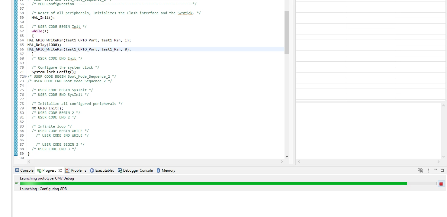

hi i am having issues with the Debug its a M7 and M4 MCU i connected swdio, swclk, swo, NRST, gnd and Vapp
the error:

fMoha.1
fMoha.1Author
March 1, 2022
this is whats happens before i see an error, it is stuck there for 5 min and then error pops up0693W00000Kb2ptQAB.png

sofLit,
i check every thing, but its not the power or the connection. i solved it by connecting the ST-Link VCC to the board VCC. when i connect the external power then i am having the problem.
