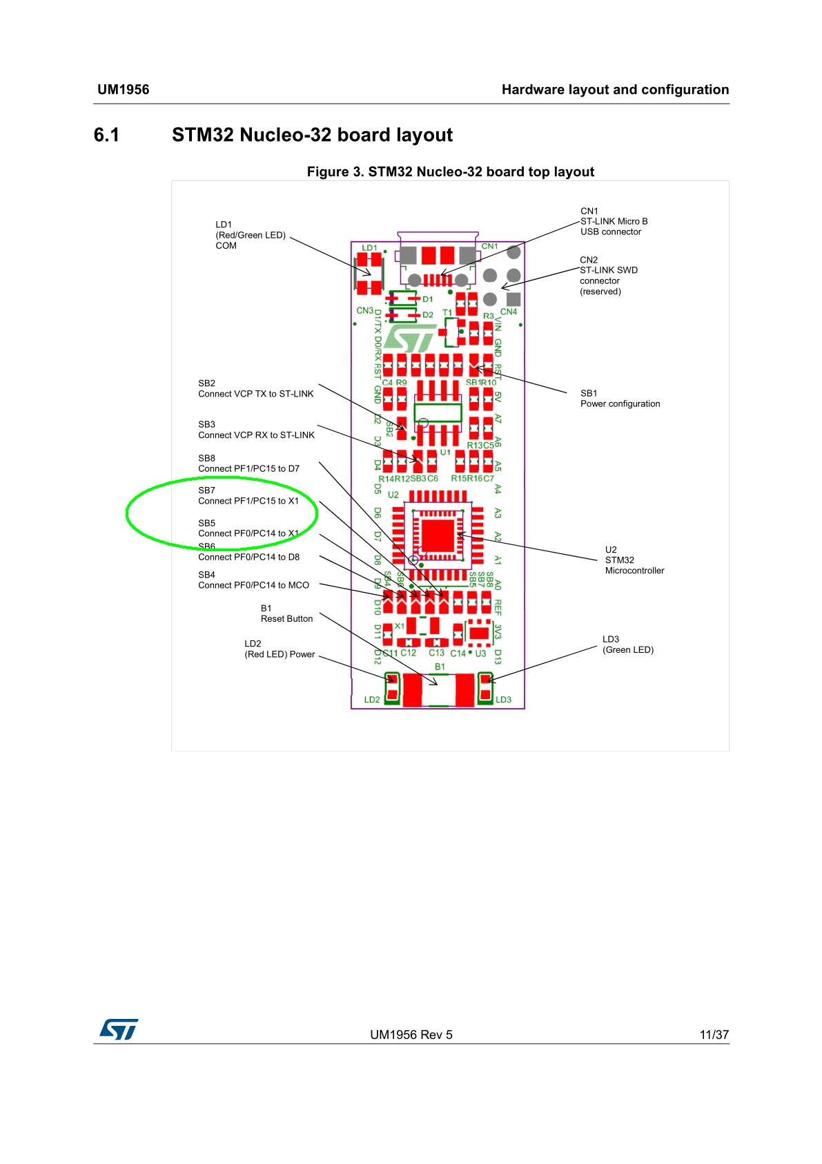

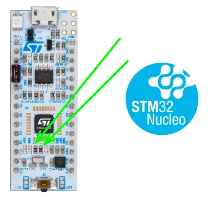

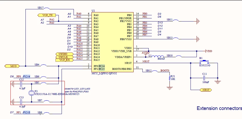

hi guy, I'm having a problem with my stm32l412kb when I'm trying to work with portC. I've looked at the schematic and I saw some switch. does someone here know how to control the switch?

this is the photo of the relevant part from the schematic0693W000001pLDqQAM.png
waclawek.jan
May 24, 2020
Your original thread: https://community.st.com/s/question/0D53W000007Yrh9SAC/hi-guys-im-having-trouble-trying-to-change-a-specific-pin
What is this, https://www.st.com/content/st_com/en/products/evaluation-tools/product-evaluation-tools/mcu-mpu-eval-tools/stm32-mcu-mpu-eval-tools/stm32-nucleo-boards/nucleo-l412kb.html ?
You may need to remove also the code which enables the LSE (i.e. click in CubeMX to disable LSE), as it overrides any GPIO settings for those two pins.

thank you very much, i chang the resistor and it is working now.
im using  LSE in a different part. do u think i still have to disable it?
