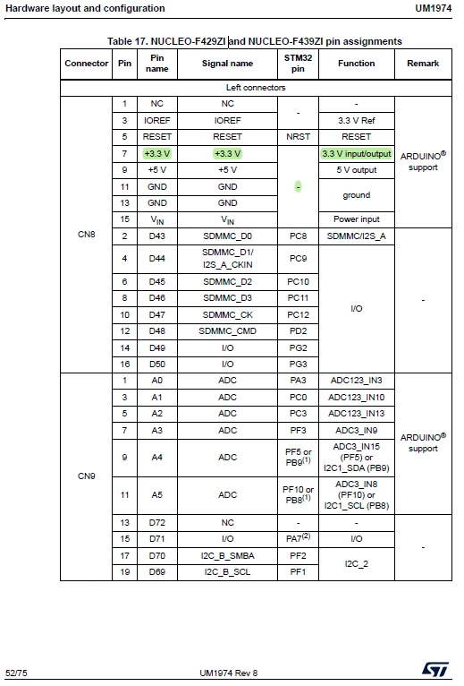

That pin seems like the one connected to the NUCLEO board 3v3 regulator´s output.
How much current requires your sensor?
The nucleo regulator seems to be LD39050PU33R with a max current output of 500ma

According to the datasheet it needs 30 mA

Go for it
