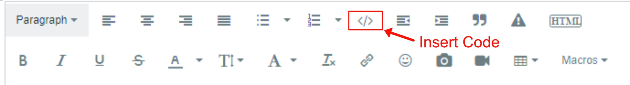

Use code insert so your code is formatted for easy reading.
