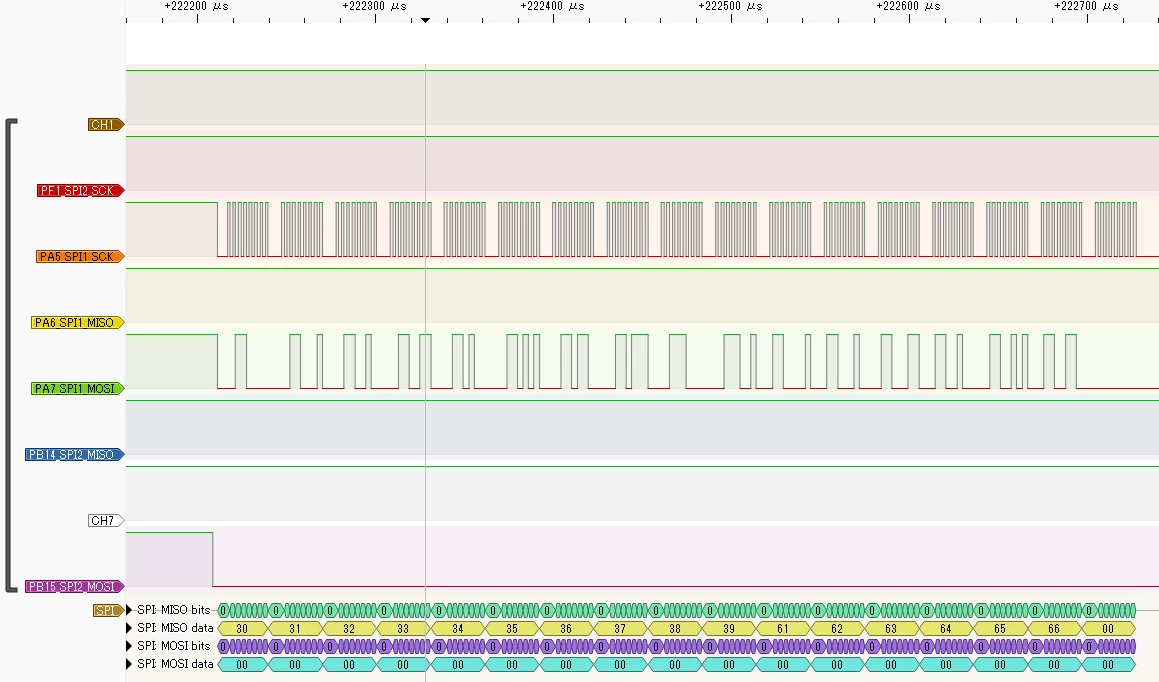

Here is the waveform for SPI1

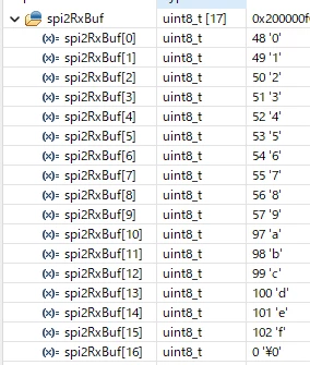

I have set a breakpoint here at /* USER CODE BEGIN 3 */, but it is not being hit.
I have set a breakpoint at SPI2_IRQHandler, but it is not being hit. Could you advise me on why the interrupt is not occurring?

You have your pins swapped. MISO (Serial Out) and MOSI (Serial In)
PA6 connects to PB15 and PA7 connects to PB14

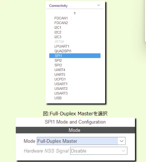

I have set SPI1 as master and SPI2 as slave.

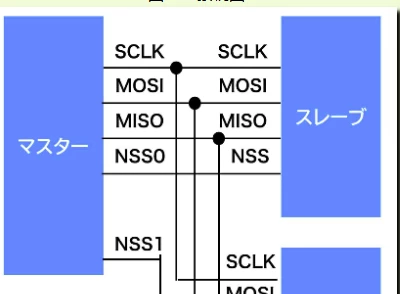

In this case, I believe I should connect PA6 to PB14 and PA7 to PB15.
Is this correct, or am I mistaken?
Dec 18, 2024 11:41 PM UTC
Based on your photo of MOSI connected to MOSI, this is incorrect. For SPI communications, MOSI on the master is connected to MISO on the slave.
MOSI = master out (master drives), slave in (slave reads)
MISO = master in, slave out
Edit: the above is nonsense. MOSI should be connected to MOSI. I was clearly distracted writing this.

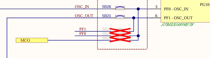

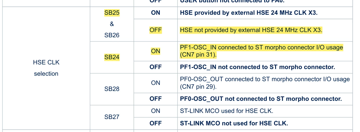

PF1 is not connected to the CN7 header by default.
Must close SB24 and open SB25.

I need to move the resistor from SB25 to SB24 with solder...
Dec 19, 2024 12:48 AM UTC
Note that my previous reply about MOSI/MISO was incorrect. It has been fixed.
The reply about SB24/SB25 is correct.
