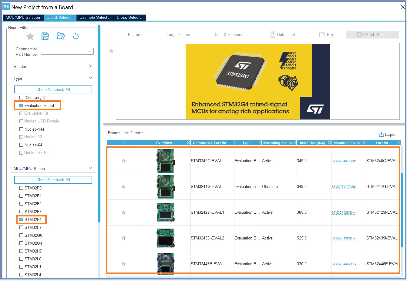

Actually, you can find in site all documents linked to the STM32F407IE.
There's no F407IE Eval board, but if you're looking for an Eval Board based on F407 device, there's the STM3240G-Eval, I would take this opportunity to present you the Board Selector under CubeMX which can facilitate your search:
Hope my answer helped you, when your question is answered, please close this topic by choosing Select as Best. This will help other users find that answer faster.

KMusz.1
KMusz.1Author
February 23, 2021
Dear Khouloud,
Thank you for your answer!
Where can I find the CubeMX Board Selector?
I need a reference design schematic for STM32F407IET
Do you think you have such design help?

The schematics for all of ST's DISCO and EVAL boards are available to download. Go to the product pages, support tab, etc..
Design support should be sought through your local sales office and FAE (Support Engineer) out of that office.
