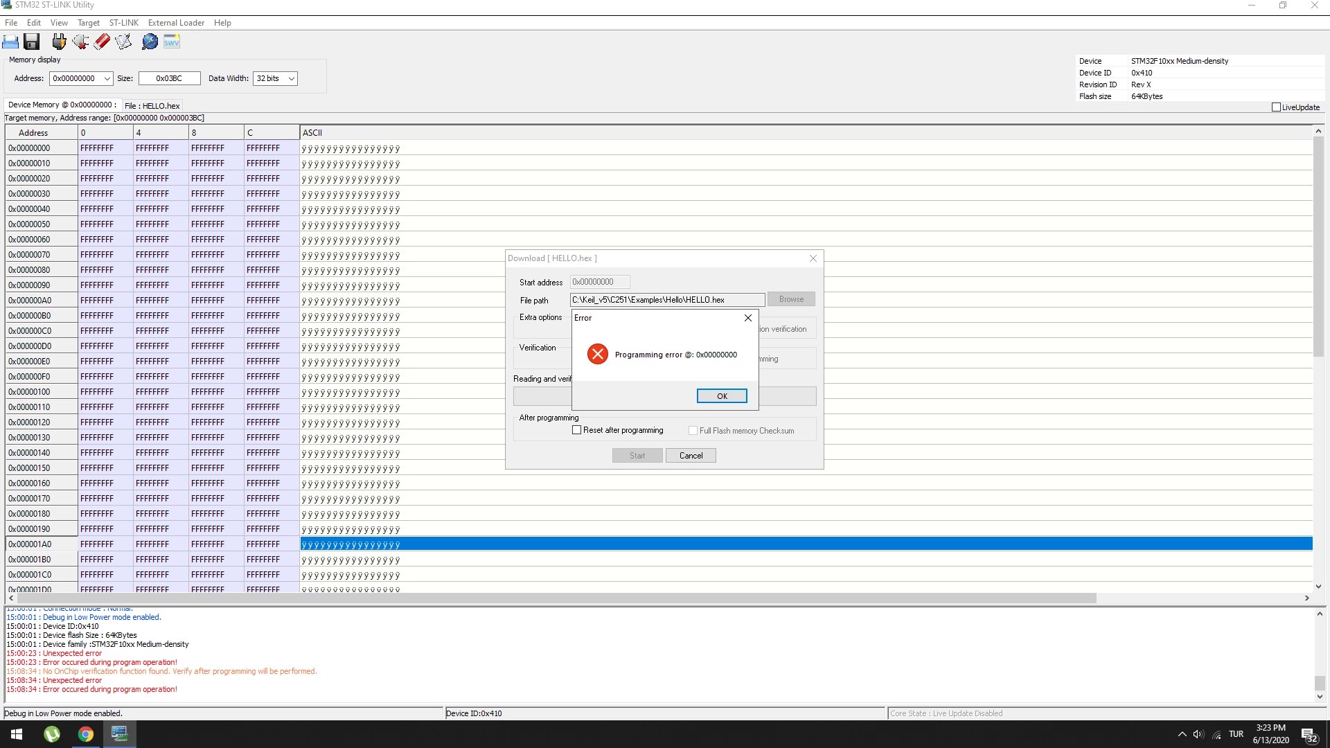

Hello, I have stm32f103c8t6 and st-link v2. I am trying to put hex file inside the microcontroller. I am able connect to the device and able to see the memory of it but I am not able to put the hex file inside the board. Can anyone help me? Best rega

Everytime I try to program the board it gives me this error.

Not going take 8051/80251 compiled files at address zero
You want to be using the Keil ARM compiler, and building at 0x08000000
