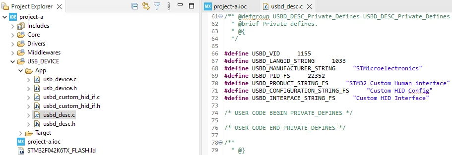

Hello. I have a simple PCB board that can be flashed with a .dfu firmware file (via DfuSeDemo for example). I'd like to change USB device name shown in Windows. What are the modifications needed to the source code? Thanks in advance for the answers.

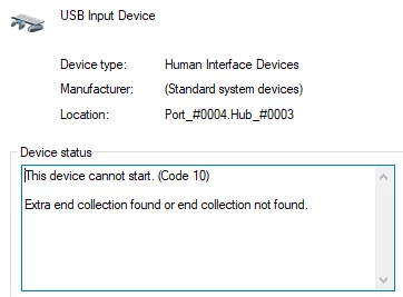

I managed to change the device name and Windows recognizes the new one but device manager shows an error -> see attached picture.
Also, the "Events" tab in USB Input Device Properties says "Device xxxxxxxxx was not migrated due to partial or ambiguous match."
Thank you for answering, I would really like to get this problem solved.

In the USB_DEVICE folder, in the file usbd_desc.c I have tried to change these lines
- #define USBD_VID
- #define USBD_MANUFACTURER_STRING
- #define USBD_PID_FS
- #define USBD_PRODUCT_STRING_FS
See attached pics also.
