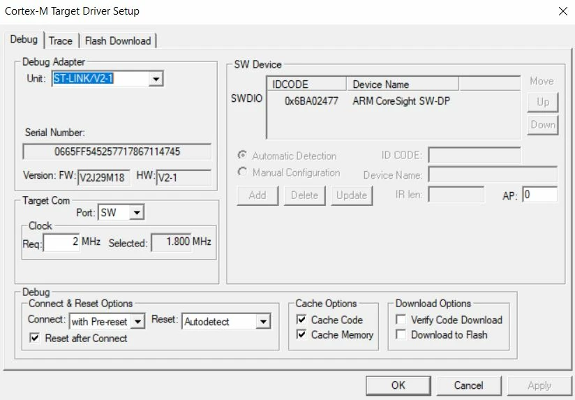

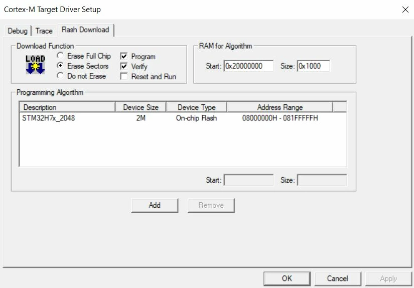

Hello, I am using STM32H743ZI and try to load program into it from uVision using ST LINK, but get the following error. What could be the problem? Thank you.

Too many errors to display !
Error: Flash Download failed - "Cortex-M7"

Go into the Flash settings and switch between the H7 Single/Dual bank algorithm, and make sure the algo is for the 0x08000000 memory space.
What version of uV5? Current DLL and Firmware for the ST-LINK?

Thank you. Please see the following setting. What do you think is the problem?

I'd start by updating the ST-LINK firmware V2J35 is more current
https://www.st.com/en/development-tools/stsw-link007.html
