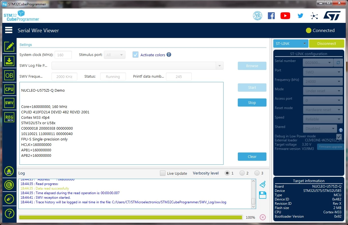

Tesla DeLorean
Tesla DeLoreanBest answer
Guru
June 23, 2022
Brian TIDAL
June 24, 2022
Hi Elio,
Can you load the hex file provided by Clive (@Community member​: thanks for your help :thumbs_up: ) and check that your able to see the ITM logs on your setup?
Regarding your program, can you display the value of SystemCoreClock in the debugger after SystemClock_Config and check this value is aligned with ClockCore value for the SWV in the debug configuration?
On your board, can you check that SB44 is present (SB44 is on the bottom close to PA0)? A solder bridge should be present.
Rgds
