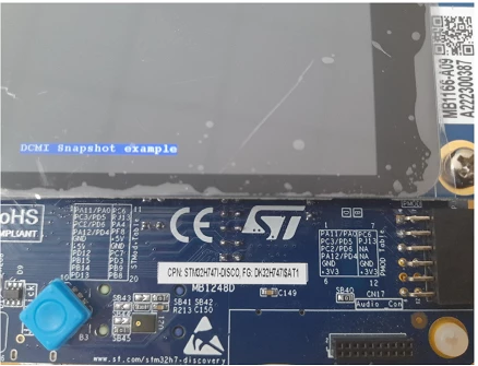

I have a trouble to interfacing B-CAMS-OMV with STM32H747I-Discovery. I used the examples DCMI_SnapshotMode on STM32CubeIDE and in other post, a ST employee said that the drivers are old and the new ones are on the github page in this link.  I tried so many times to use this example with the new drivers and its not working and the LCD displays only noise. The LCD works well because I tested some LCD_DSI and works fine. I've missed something on the code?

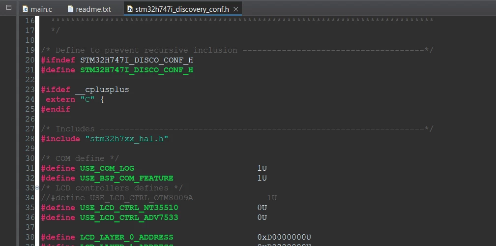

brunamarkAuthor
January 3, 2024

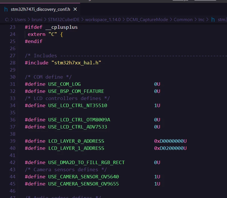

I'm completely new to stm32, I really appreciate your help! I have checked the wiki that you mentioned before to add drivers. I modified the stm32h747i_discovery_conf.h file like the black box below, but it doesn't work (I don't know if this is what are you trying to say). Also, when I disable the OTM8009A, I have several issues in other parts like OTM8009A_480X800 undeclared and I don't know if I have to change all this parts to NT35510.
#include "stm32h7xx_hal.h"
/* COM define */
#define USE_COM_LOG 1U
#define USE_BSP_COM_FEATURE 1U
/* LCD controllers defines */
#define USE_LCD_CTRL_OTM8009A 0U
#define USE_LCD_CTRL_NT35510 1U
#define USE_LCD_CTRL_ADV7533 0U
#define LCD_LAYER_0_ADDRESS 0xD0000000U
#define LCD_LAYER_1_ADDRESS 0xD0200000U

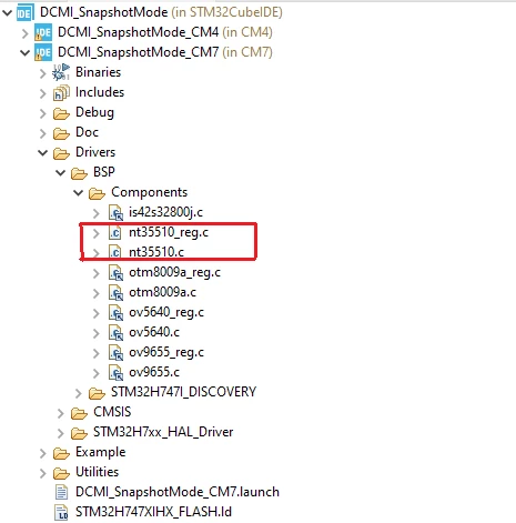

7- Add "nt35510.c" and "nt35510_reg.c" files to the STM32CubeIDE project. So, drag and drop the nt35510.c and nt35510_reg.c files in STM32CubeIDE from STM32Cube\Repository\STM32Cube_FW_H7_V1.11.1\Drivers\BSP\Components\nt35510 as shown in the below figure:

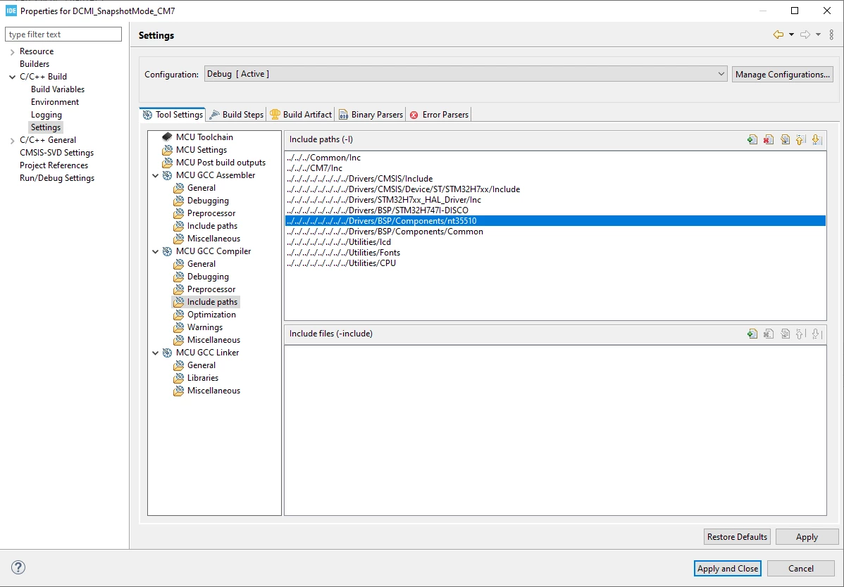

8-Add the STM32Cube\Repository\STM32Cube_FW_H7_V1.11.1\Drivers\BSP\Components\nt35510 folder to the include paths, so, click on Project->Properties and follow the instructions below:
I add in attachment the DCMI_SnapshotMode project after all modification.

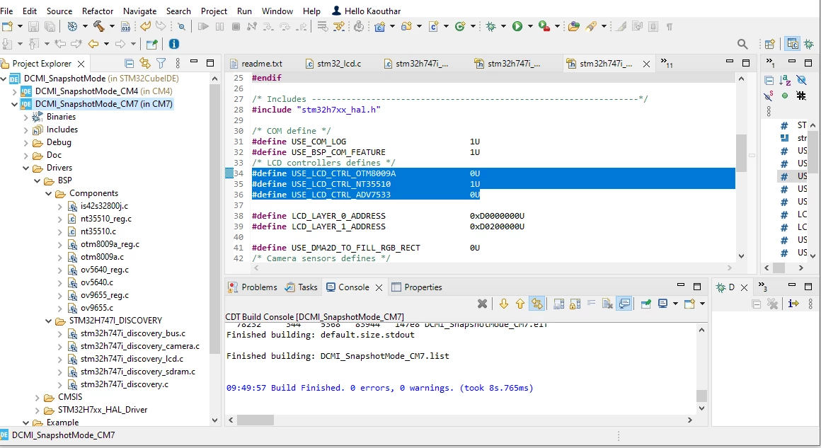

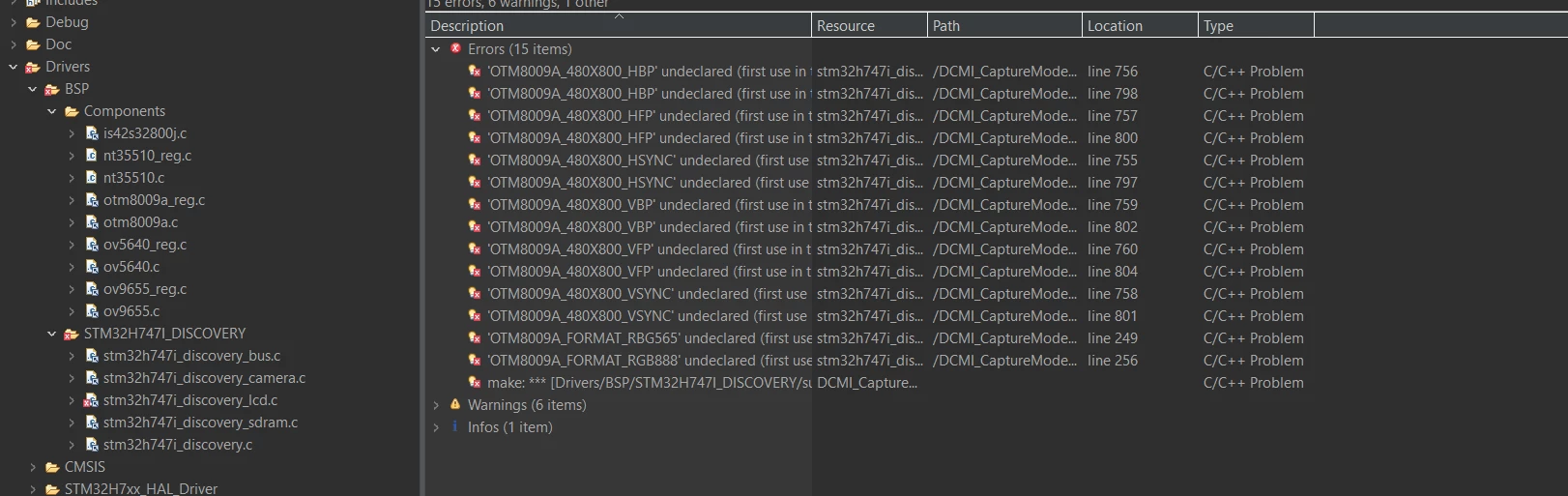

brunamarkAuthor
January 5, 2024
I have to thank you again to explain it to me but isn't work. I followed all the steps you mentioned and when I modified the stm32h747i_discovery_conf.h file, I have the same issue that I mentioned before. This is the error that shows on my console:
This is due the OTM8009A deactivation onstm32h747i_discovery_conf.h file, as shown in the below:
Even if I activate nt35510 and otm8009a, it displays only noise in the LCD.

brunamarkAuthor
January 5, 2024

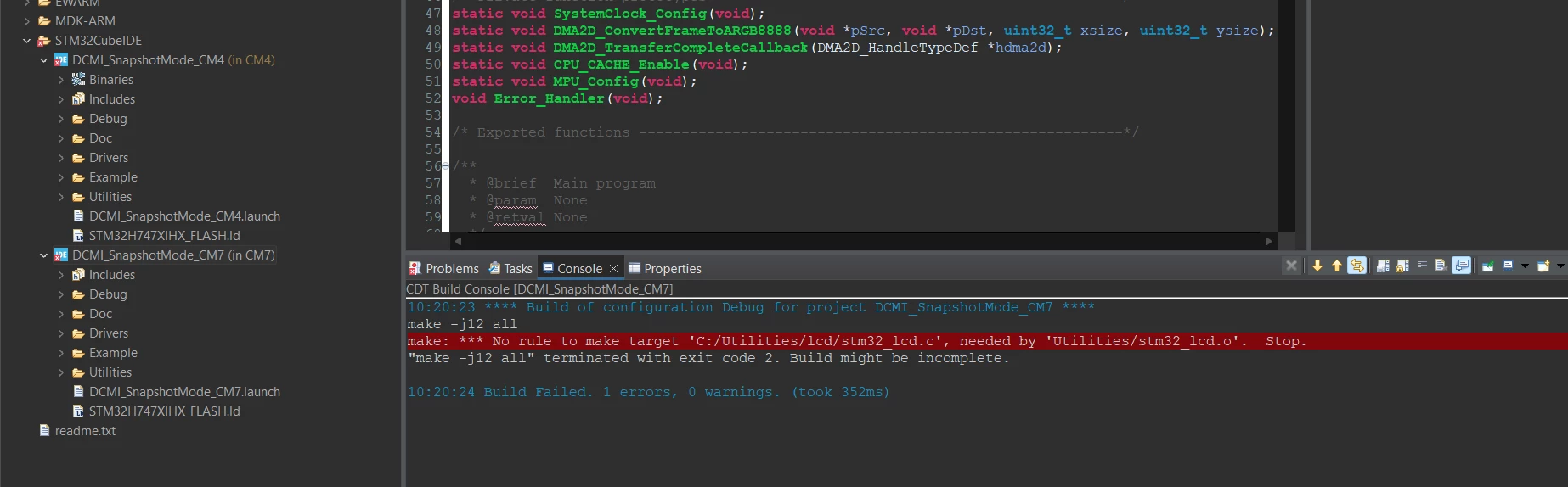

The project that you attached before, I've tried to run and I have this message <No rule to make target 'C:/Utilities/lcd/stm32_lcd.c', needed by 'Utilities/stm32_lcd.o'. Stop.>. I mean disable the OTM8009A put into 0U or commented in the line that are defined.

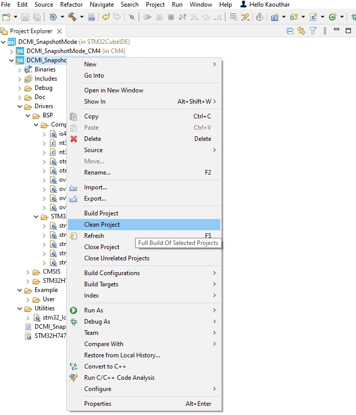

KDJEM.1
January 8, 2024
Hi @brunamark ,
Could you please try to "Clean Project" before "Build Project".
I disabled the OTM8009A and I didn't reproduced the issue.
Please make sure that Step2 is set correctly.
Please try to:
- Download the project in attachment and unzipped.
- Open STM32CubeDCMI_Example\STM32Cube_FW_H7_V1.11.1\Projects\STM32H747I-DISCO\Examples\DCMI\DCMI_SnapshotMode\STM32CubeIDE project.
-Clean Project
-Built Project.
Please let me know if the issue is solved.
Thank you.
Kaouthar

I clicked on the wrong button and I accepted the solution but it's still having issues. I make sure all the steps are done but when I build the project, I ahve the same issue. I've unzip your file and I didn't change anything but I have the same issue, as shown as in the images below.

I solved my problems with this steps:
1) in the stm32h747i_discovery file, I use thesse paramaters:
In your zip file, the USE_LCD_NT35510 is set to 0U.
2) Also, when I downloaded the new drivers file, the STM32H7xx_HAL_Driver has missing some files and I use the old files,
Thank you for helping me!
