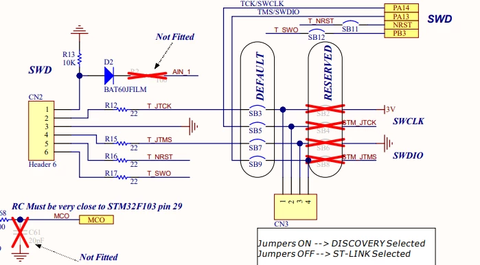

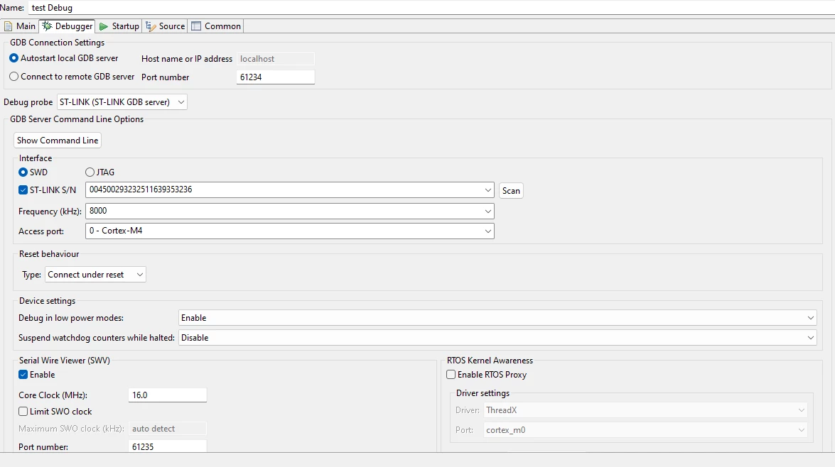

I am trying to connect to the processor STM32L431CCT6TR via SWD connection, but it says no device found.  Blowe, I have pasted the message and debugger setup information.  It is able to find the debugger. I have also attached the schematic if
I appreciate the help.

STMicroelectronics ST-LINK GDB server. Version 7.4.0
Copyright (c) 2023, STMicroelectronics. All rights reserved.
Starting server with the following options:
Persistent Mode : Disabled
Logging Level : 1
Listen Port Number : 61234
Status Refresh Delay : 15s
Verbose Mode : Disabled
SWD Debug : Enabled
InitWhile : Enabled
Target no device found
Error in initializing ST-LINK device.
Reason: No device found on target.

Hello @Mehul and Welcome to the Community :)
I advise you to connect under reset mode.
Check boot pin, NRST and SWD signal.
Also, make sure to upgrade the firmware.
Imen

Thanks for the response. I have pull-down on boot.  I have NRST is pulled high.  I have upgraded the firmware on the programmer.
Moreover, I tried connecting the programmer to discovery board, but I was not able to read the memory with ST utility tool.
Here is the connection that I had used.   I had removed the jumper, so I can communicate.
