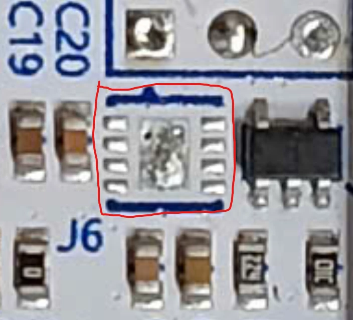

I am currently working on repairing my NUCLEO-F767ZI board (Revision: [MB1137 Rev B]). The 3.3V LDO regulator (U6) was damaged and needs to be replaced.
While working on it, I found a hardware discrepancy:
  • According to the official schematic, U6 is specified as LD39050PU33R (a 6-pin DFN package).
  • However, on my physical board, the PCB footprint for U6 clearly has 8 pads.
  • The damaged original IC I removed is an 8-pin package with the marking code "PH 2kE".
Since a 6-pin IC cannot fit on this 8-pin footprint, has anyone encountered this before? Could you please help me identify the correct 8-pin LDO part number to replace it?
I have attached pictures of the physical 8-pin IC and the 8-pad PCB footprint for reference.
Any advice would be greatly appreciated. Thanks in advance!
Figure 1: The removed original 8-pin LDO IC with the marking code "PH 2kE".
Figure 2: The physical 8-pad PCB footprint for U6 on the NUCLEO-F767ZI board.

AScha.3
Sep 6, 2026 6:58 PM UTC
so your 3v3 LDO is probably LD39200DPU33R .
https://www.st.com/resource/en/datasheet/ld39200.pdf
in DFN8 package.
Check the connections in -- out on your board, from solder pads :  pin 7-8 connects to 5V on board ?
if pin 1-2-3 connected, = LD39200DPU33R ; connects to 3v3 on board ?

Hi A Scha.3,
Thank you for the suggestion! I checked the board layout and performed some continuity tests based on your description, but here is what I found:
  • Only one pin on the top-left (as shown in Figure 2) is connected to 3.3V (instead of pins 1-2-3).
  • The two pins connected to 5V are located at the top and bottom rather than adjacent pins (like pins 7-8 in the datasheet).
Since these results don't seem to match the standard LD39200 DFN8 layout, are there any other specific measurements or tests you would recommend I perform to help identify the correct IC?
Thanks again for your help!

So check pinout /matching for AP7361C-33FGE-7 :
https://www.mouser.de/datasheet/3/175/1/AP7361C.pdf
CongTienAuthor
Sep 7, 2026 8:59 AM UTC
I just checked pin 4 (bottom-left in Figure 2), and it is indeed connected to GND.
Also, following your lead on Diodes Inc., I found that the older AP7361-33 actually uses the "PH" marking code! Since both the AP7361 and the AP7361C share the same package type (U-DFN3030-8 Type E) and pinout, would either of them be a good replacement?
Thanks again!

Good find on the PH marking. I would still compare the electrical specifications before treating the AP7361-33 and AP7361C-33 as direct drop-in replacements.
The original AP7361-33 and the AP7361C family are both available in the U-DFN3030-8 package, and the pin functions appear compatible. However, the AP7361C has some changed specifications, including output accuracy, dropout characteristics, quiescent current, and current-limit behavior.
So if the application is not especially sensitive to those differences, the AP7361C-33 may be a suitable replacement, but I would verify the input voltage, EN behavior, output capacitor requirements, load current, and thermal conditions against the original circuit first.
The AP7361 datasheet also identifies the older AP7361 as NRND and points to the AP7361C as the newer device, which makes the C version worth considering for a replacement.
I'd be interested to know whether anyone has actually tested the AP7361C-33 as a drop-in replacement on this particular board.

Hi everyone,
Sorry for the delayed update. I successfully replaced U6 with the AP7361C-33FGE-7.
STM32CubeProgrammer now recognizes the MCU perfectly, confirming that the 3.3V line is stable and the AP7361C-33 is indeed a perfect drop-in replacement for this board.
Thanks again to @A Scha.3 and @Kelvintavarez for your great support!
