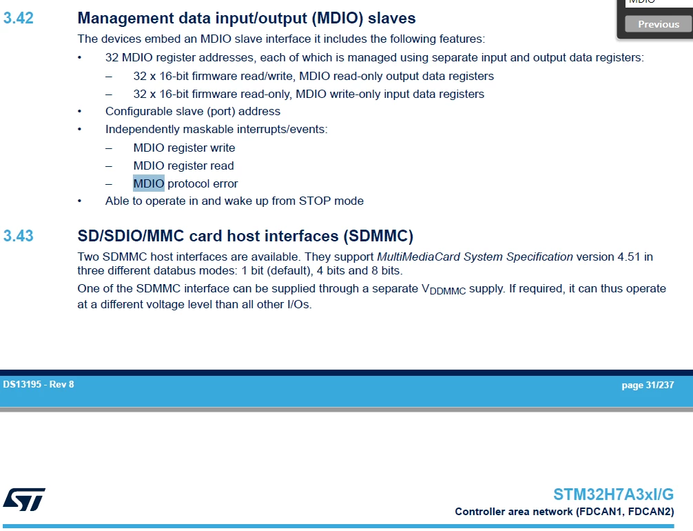

Hello everyone,
I would like to know if the Nucleo-H7A3ZI-Q supports the MDIO to external Ethernet PHY control via SMI (MDC and MDIO). I have the setup connected, and I have programmed it accordingly but the MDC and MDIO Lines are always LOW, not even a hint of toggling or any thing on the PINS when viewed on a logic analyser.
This brings me to my question. Does the Nucleo-H7A3ZI-Q support control on an external PHY.

Hello @Promise_Conti ,
MDIOS can't communicate with an external PHY because the PHY will behave as a slave also so no one will initiate the communication.
you need to have a master communicating with MDIOS providing its clock so normally you will not see any traffic on the MDIO /MDC lines as a clock and a command to the address programmed in the slave should be provided.
otherwise MDIO/MDC are quite simple to emulate using normal GPIO if you are constrained to use this product series, or you can switch to a product supporting master MDIO/MDC communication.
please refer to sections 59.3.3 and 59.3.5 of RM.

As LCE wrote, the STM32H7A3 series don't have Ethernet . In particular, no ethernet MAC component.
There is a STM32 peripheral called "MDIOS" ("Management data input/output") that could be used for very basic serial interface, but the Ethernet MAC component is missing in this specific STM32H7 to do real Ethernet communication with an external PHY.

Interesting, I never saw the MDIO interface on ICs without ethernet before.
If there's no ETH peripheral, you cannot init it.
But then you probably have to init the MDIO peripheral (it looks like it is an extra peripheral), starting with the clock etcpp.
And init the GPIOs with the MDIO alternate functions (check datasheet), which you probably do in  "static void MX_MDIOS_Init(void);" ?

I don't know the H7A, but from the screenshot it looks like the H7A has an MDIO peripheral, very similar to other peripherals, like SPI, I2C, ADC...
So only guessing from here (no time to download and check datasheet / ref manual -> your job), if MDIO is a peripheral, it is usually set up / initialized by:
- starting the peripheral clock (some HAL function like HAL_CLK_ENABLE_MDIO() or so)
- configuring the GPIO pins
- setting some MDIO registers
Is there a function like "MX_MDIO_init()" or so?

Hello @STea ,
You are right, the Nucleo-H7A3ZI-Q cannot initiate the SMI communication because it is also a SLAVE ( I found this choice of architecture really fascinating as I would have expected MCUs to serve as ETH MAC Master and definately not as SLAVE to another MCU).
This issue seems to also have been treated here How to generate MDC
Thanks for your support, I will switch to another Product

@STea just curious, what's that MDIO slave-only interface for?
October 10, 2024
Hello @LCE ,
a usecase that I imagine is possible for this Periph is to control switch ports VIA gpios by receiving commands form to manage network stations for example. it can be set to communicate networking configuration Data as well.
