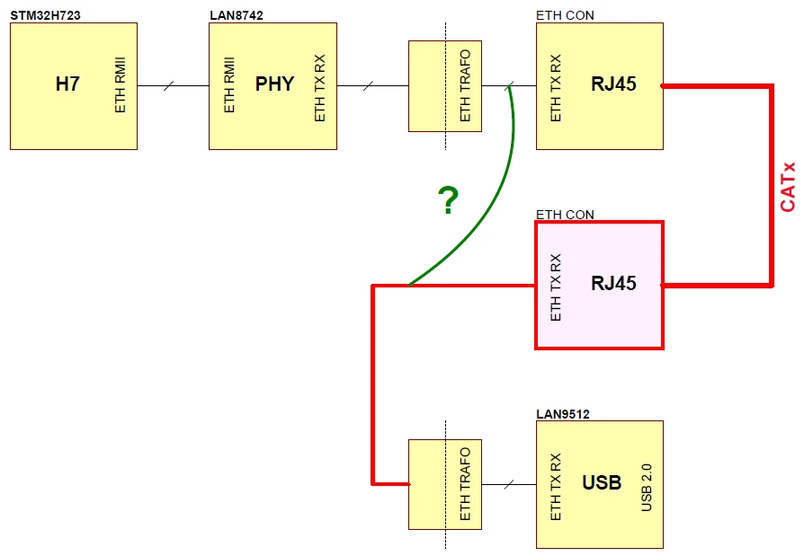

Hello circuit designers and PCB guys,
I have a problem of how to connect the H7 ethernet via a PHY and a ethernet USB bridge.
  • to the outside world:
    • ethernet connection via RJ45 to host
    • USB connection to host (e.g. laptop without ethernet)
  • I must NOT use the H7's USB interface, another USB driver is out of the question (says the SW department)
  • with a ethernet-USB bridge the H7-device looks like any other ethernet device, no USB driver needed
So I tested Microchip's LAN9512 ethernet-USB bridge on their dev board, that works great, see attached picture.
Problem:
I have to place the LAN9512 on the same PCB, and I must get rid of that extra RJ45/magnetics + cable (the red parts in the attached pic).
I must use as few components as possible, but how should I wire these parts without making it too dirty (it must work reliably and has to pass a EMI test someday...).
  • Possibly the cleanest solution might be using a multi-port PHY like the LAN9303 (anybody used that?), and switching ports when USB is attached.
  • The not so clean version would be to place the USB's ethernet transformer very close to the regular ethernet transformer at the RJ45 (see green line with the "?"). But as we're having 125 MHz signals there and driving 2 transformers all of a sudden, this sounds like a stupid idea...
Any thoughts on that or other ideas?
Or experience with multiport PHYs like the LAN9303?

Magnetics are only needed for going off-board over (potentially) long distances and to devices with (potentially) different ground references. When both ends on are the same PCB you can usually capacitive couple the signals. You may need 50 ohm pullups depending on whether the PHY is voltage mode or current mode. I think the LAN 8742 is current mode, but I don't recall for sure. If the sample schematics for the PHY show pullups on the RX/TX signals going to the magnetics then they are current mode drivers and you will need the pullups.

But I assume I would "overload" the "main" PHY (like LAN8742) / line by connecting its ethernet side to a transformer (and RJ45 and 100m CAT...) and the USB-bridge PHY via the caps?
That's my main question right now, if anybody's done that successfully, or if I need a "dual PHY" like the LAN9303.

Hmmm, maybe I mis-understood your requirement. Do you need to keep the LAN8742->Magnetics->RJ45 path, and ADD the ability to connect LAN8742->LAN9512?
If so, can BOTH interfaces be active at the same time? That is not allowed without putting a hub/switch on the board (i.e. LAN9303 as you suggest).
