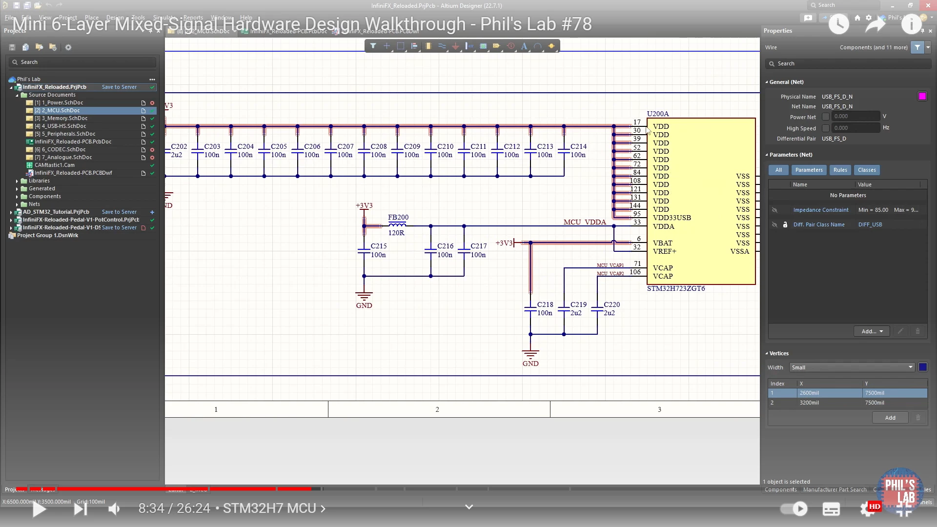

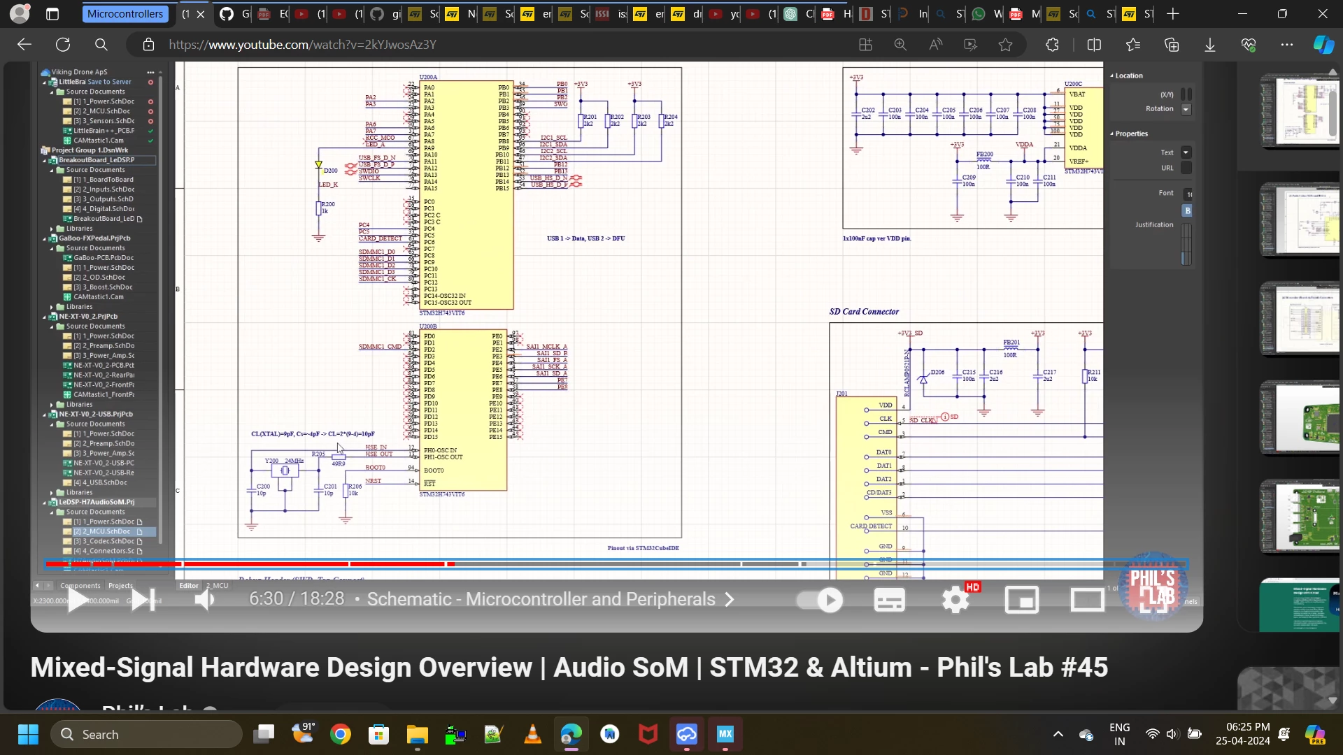

As I'm new to PCB design, I initially followed a video for the STM32H723 MCU in an LQFP144 package. However, I later realized that the GPIOs would not be sufficient for my project. Consequently, I found another video featuring the STM32H743 VIT6 in an LQFP100 package, and I decided to replace all the pins from the H723 with those from an H743 in an LQFP208 package. I have some doubts about this approach. Is it correct to swap the GPIOs and make slight corrections to the crystal circuit, VSS, and VDDs by referring to the schematics for the H743 with 100 pins? Or should I follow the reference schematics for the STM32H743 Discovery board, or can I simply follow the video for the H743 in an LQFP100 package?"
Mixed-Signal Hardware Design Overview | Audio SoM | STM32 & Altium - Phil's Lab #45 (youtube.com)
Mini 6-Layer Mixed-Signal Hardware Design Walkthrough - Phil's Lab #78 (youtube.com)

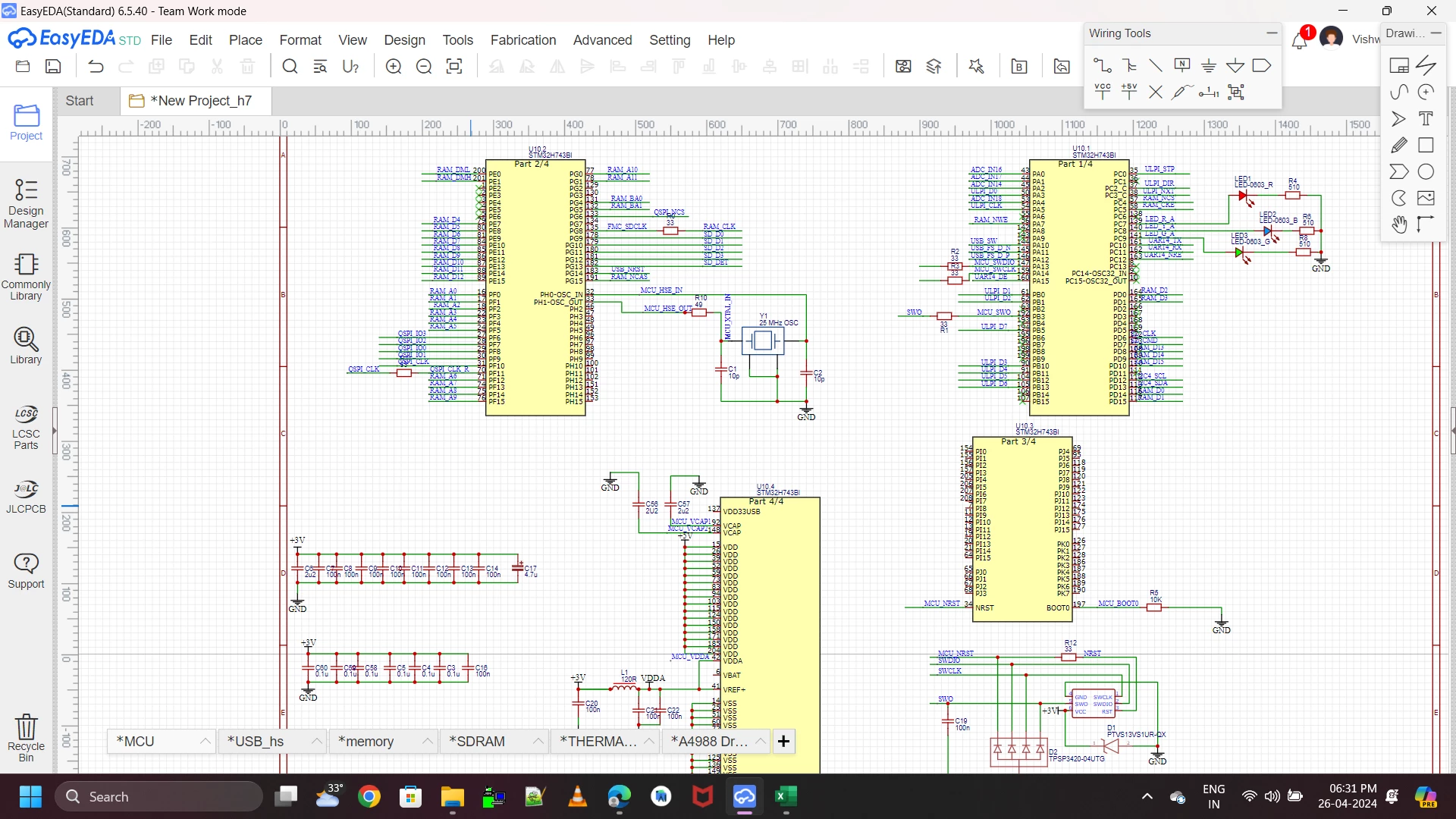

I don't know these videos, but in case of doubt I would follow ST's evaluation boards.
Not necessarily when it comes to PCB layout details, because the ST eval boards are built for multiple use cases, which leads to some terribly long signal lines and other issues.
Anyway, read / check / compare datasheets, reference manuals, application notes.
New to PCB design and doing layout for a medical device? Good luck... ;)
Do you have some senior engineers for advice and double checking your work?

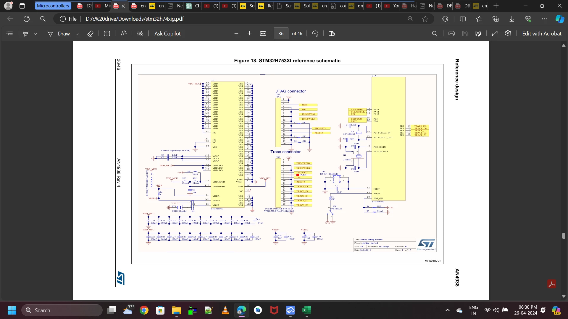

Thank you for your kind reply. Yes, my role is solely to select the chip and design the schematics, while a senior colleague handles the PCB design. However, he is not familiar with the STM32. Another colleague and I are involved in developing our company's own product using STM32. We have successfully demonstrated this using the F769-DISCO board, and now I need to use an 8.88" display with at least a 1080x800 resolution, so I decided on the H7. Unfortunately, I initially learned schematics from a dedicated H743 100-pin video. As I require SDRAM, LTDC, and eMMC, this would occupy many pins, so I switched to the STM32H743 in a 208 LQFP package instead of the previous one.
As you mentioned, I found a reference schematic for the H753 in the hardware application note. If I follow this reference schematic exactly, will my MCU function properly? Regarding the selection of active components, which should I prioritize? The STM32H753 eval board contains complicated and obsolete parts. What steps should I take after following the basic schematics provided in the reference?
this is partially followed by ref..

April 26, 2024
STM32H753 is exactly same as STM32H743, and has crypto features that may be useful for you.
The only thing to worry about: make sure it is "stepping V", not "stepping Y". The latter is obsolete.
