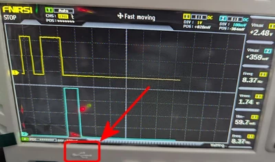

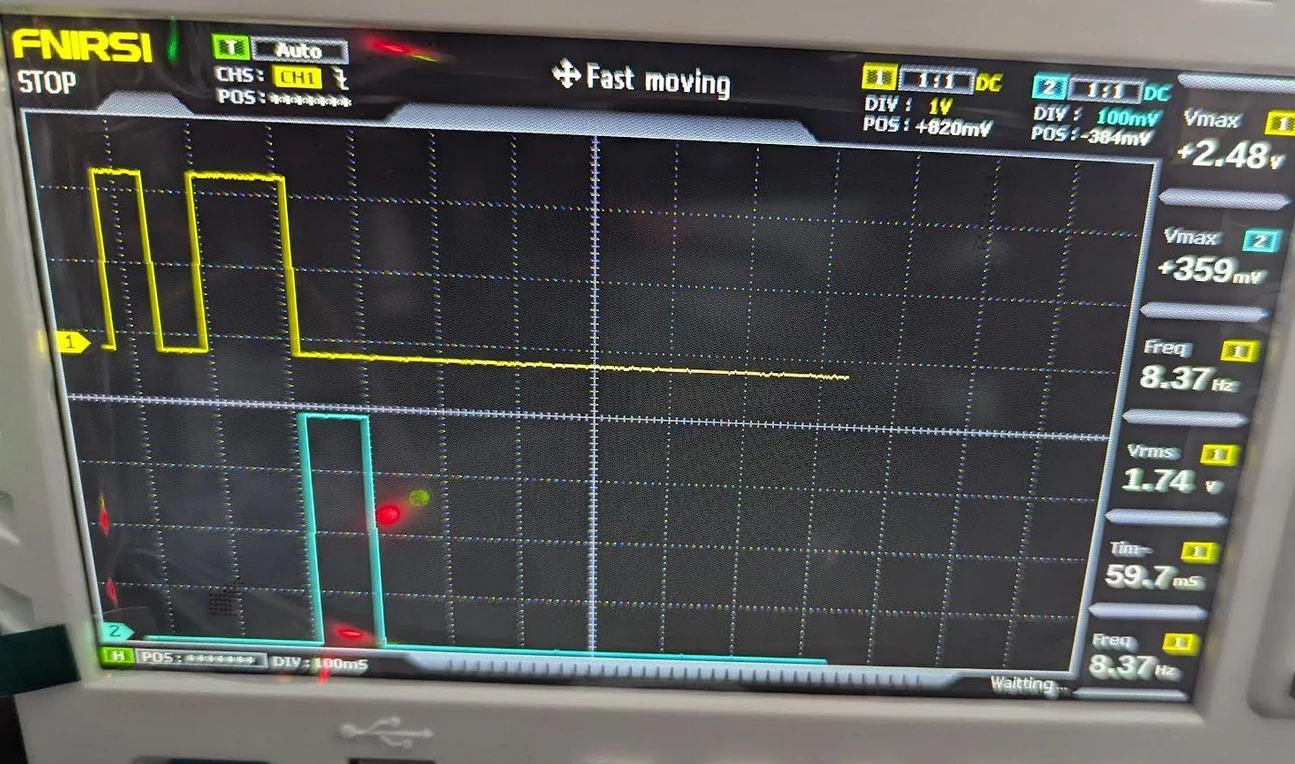

I'm using a Nucleo-H723VG board and trying to use the PB8 and PB9 pins. I'm able to set PB9 high and see a voltage of 3V but for PB8 it only shows a voltage of 359mv. I have tried enabling the internal pullup and still doesn't go high to 3V.
The yellow is PB9, which is going high and blue is PB8, only reads in mv range.

Are you sure your scope isnt 1:10
jasd33pAuthor
September 4, 2024
Yes there 1:1
MM..1
September 4, 2024
Show photo board, i mean ST dont have VG nucleo, but ZG
And 1:1 on display is irelevant, check cable switch

It looks like your scope has a USB socket:
You should be able to use that to download a proper screenshot - which will be much better than a wonky photo with reflections, etc!

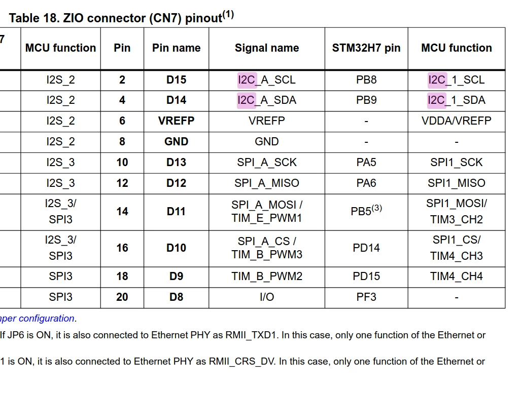

On which connector and which pin you are probing PB8? CN9/11? or CN12/3?
On CN9/11, the solder bridge is not soldered.
jasd33pAuthor
September 4, 2024
I was probing PB9 on CN7
