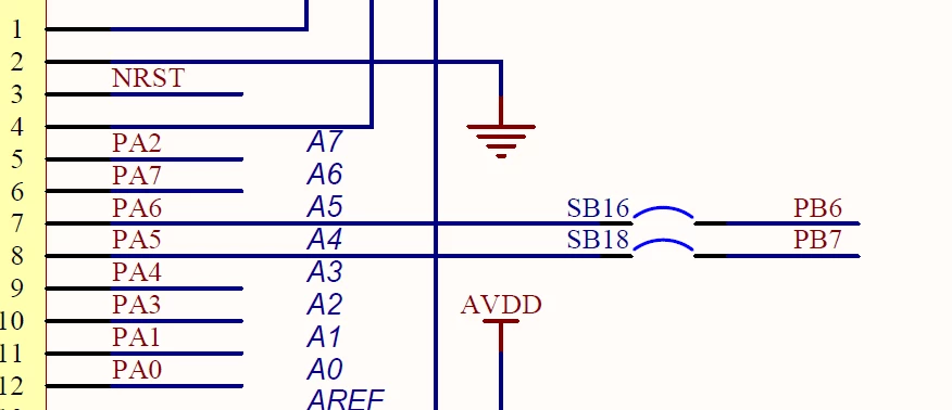

I have three GPIOs output configured. I'm having some strangeness on two of these that I don't quite understand.
I'm using a nucleo STM32L432KC, and I have some custom circuitry attached to the GPIOs (detailed below)
The situation I am experiencing is as follow.
When I set the 3 GPIOs like so, I have expected results.

Should show PB7 low, PA5 high ad PA low.
But instead I see this:
0693W00000Kb8UDQAZ.pngPA5 appears to be bouncing all over the place, and once in a awhile PB7 does as well.
(This is short sample, of like 5 seconds)

Each circuit is tied to a 10k pulldown resistor.
PA6
0693W00000Kb8WEQAZ.pngPA5
0693W00000Kb8WJQAZ.pngPB7
I don't quite understand a) why won't PA5 stay up, and how is PB7 somehow tied to PA5.
If anyone has some ides, I'd appreciate it.
Best answer by jgauthier
Thanks! I finally figured it out,
PA and PB7 are directly connected through solder bridge on the Nucleo. I removed the bridge.

Peter BENSCH
March 2, 2022
The npn bipolar transistors are current driven and emitter followers, so you'd need some load connected to them. What is connected at the outputs?
Regards
/Peter

I didn't have a load, actually. But I attached my intended load. Which are 2 24V solenoids (relays not pictured)
The behavior is the same regardless. So, I am still hunting - maybe it's hardware issue.
Michal Dudka
Lead
March 2, 2022
1) Check output voltages by oscilloscope (or multimeter). Probably there are "analog" values.
2) Check your GPIO settings (are GPIOs outputs ? in push-pull mode ?)
3) Check HW for short circuits (bad soldering)
jgauthier
jgauthierAuthorBest answer
Senior
March 2, 2022
