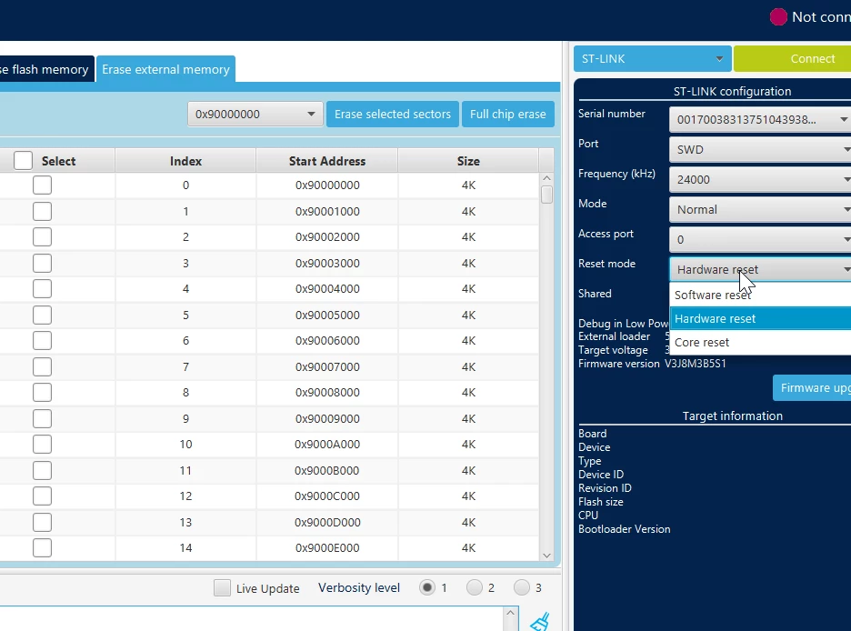

Hueli.1
August 12, 2022
I had the same issue after flashing a corrupted build.
The solution is to select Hardware reset under Reset mode in STM32Cube Programmer0693W00000QNa8kQAD.png
